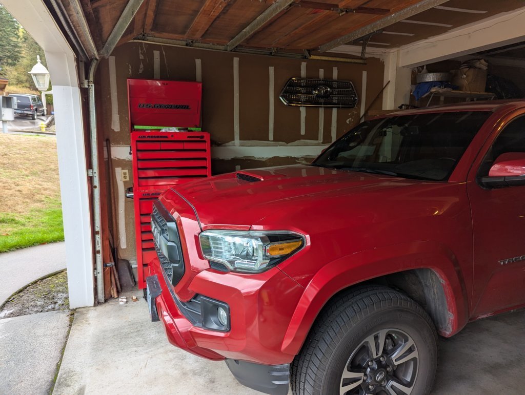

    I keep rat bait and snap traps in my garage (see the picture below near the shovel). I have since moved the little cups of rat bait and traps under my rolling tool cabinet where my Golden Retriever can’t reach. If rodents get into my garage, I am hoping they are attracted to my tool cabinet and not my truck.
    Mxoran[OP] likes this.
