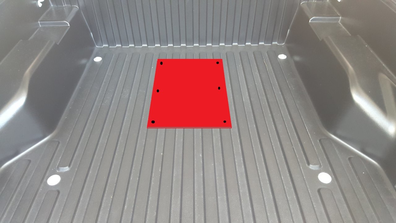

    Anybody here can cut a custom plate from aluminum? Is roughly 13.5" X 16" X .5".
    Needs to be cut by plasma, water, laser, etc.
    Will be used as a base plate on the bed to support the spare tire.
    Below is the pic and I can send the CAD file. How muck $$$ ?

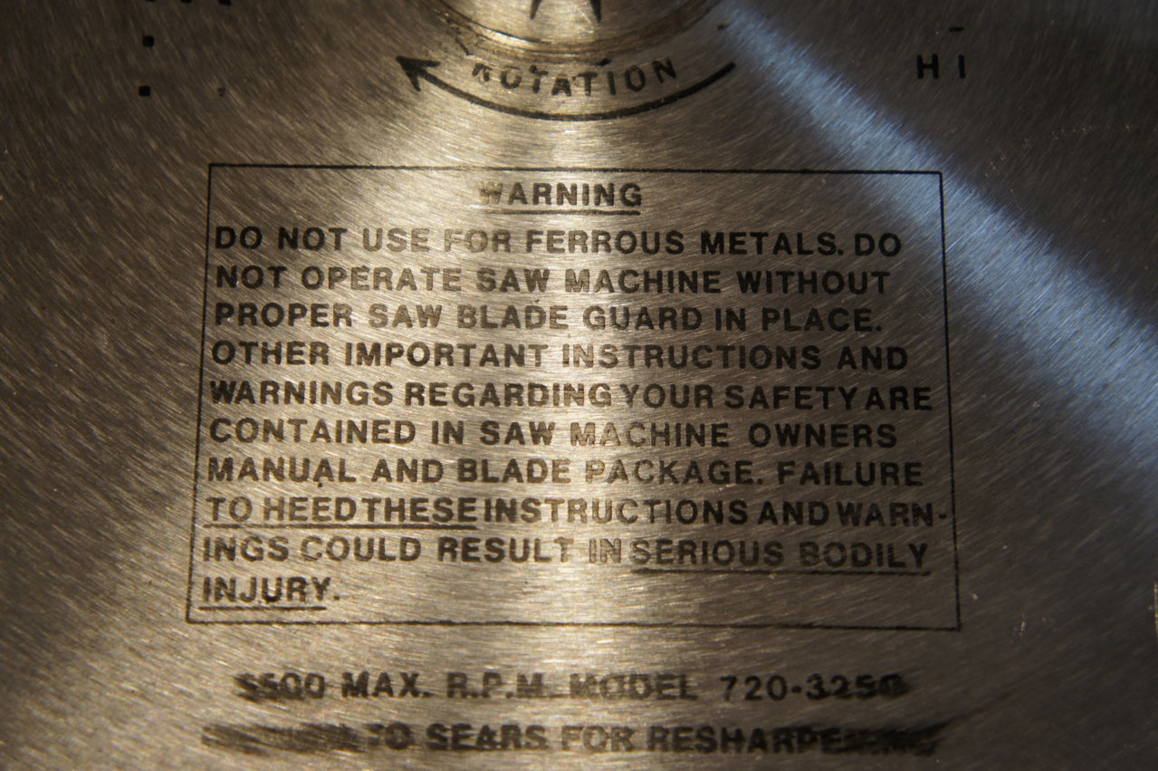

    I cut alum on my table saw. Although, I never have cut 1/2 inch. For steel I replace the carbide blade (in the table saw or chop saw) for a 10 inch silicon alum abrasive disk.

    For aluminum (and copper), I use a combination carbide blade. You want something with a non-aggressive rake. Read the warning on the blade it will say something like not for Ferrous metals. For steel, I use/need a 10 inch silicon carbide abrasive disk.
