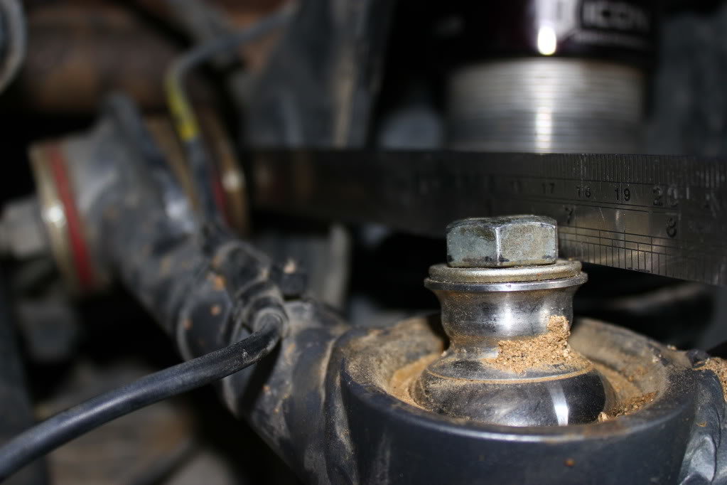

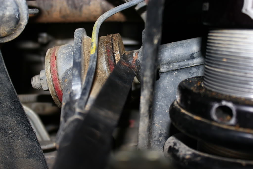

    I have a sneeking suspicion that there's something strange about my mid-travel total chaos UCA. Will anyone with a 2nd gen tacoma take a meaurement of their chaos uca between the two points illustrated in the picture for me (i.e. center of the uniball and the long control arm bolt)? Thanks in advance!

    Not enough.
    6 3/4"
    Keep in mind we might be at different heights.

    Thanks Goose.
    Dam, I'm really confused then. I have this negative camber issue I've been chasing around. Today Dellosa89 came over and I took a bunch of measurements off of his truck. He has the camburg mid travel set up. Anyhow he doesn't have any alignment issues and the only differences I could find between his setup and mine was the length of the UCA. His UCA was 7-3/8 between the pts shown in my pics.

    Sure looks normal to me. I just don't understand what's wrong... I guess I need to park next to another mid travel taco and get out the tape measurer again. Thanks for posting.
