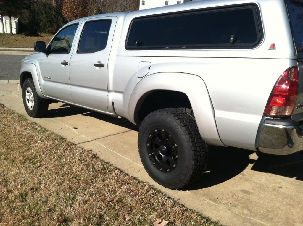

    13 DCSB TRD Sport 4X4
    17x8.5 0 offset 4.75 bs put my tire tread dead even with flare. Its not just the offset that plays a role in how far they stick out or in but also overall width and backspacing. The wheel is turned to the right slightly in picture.
