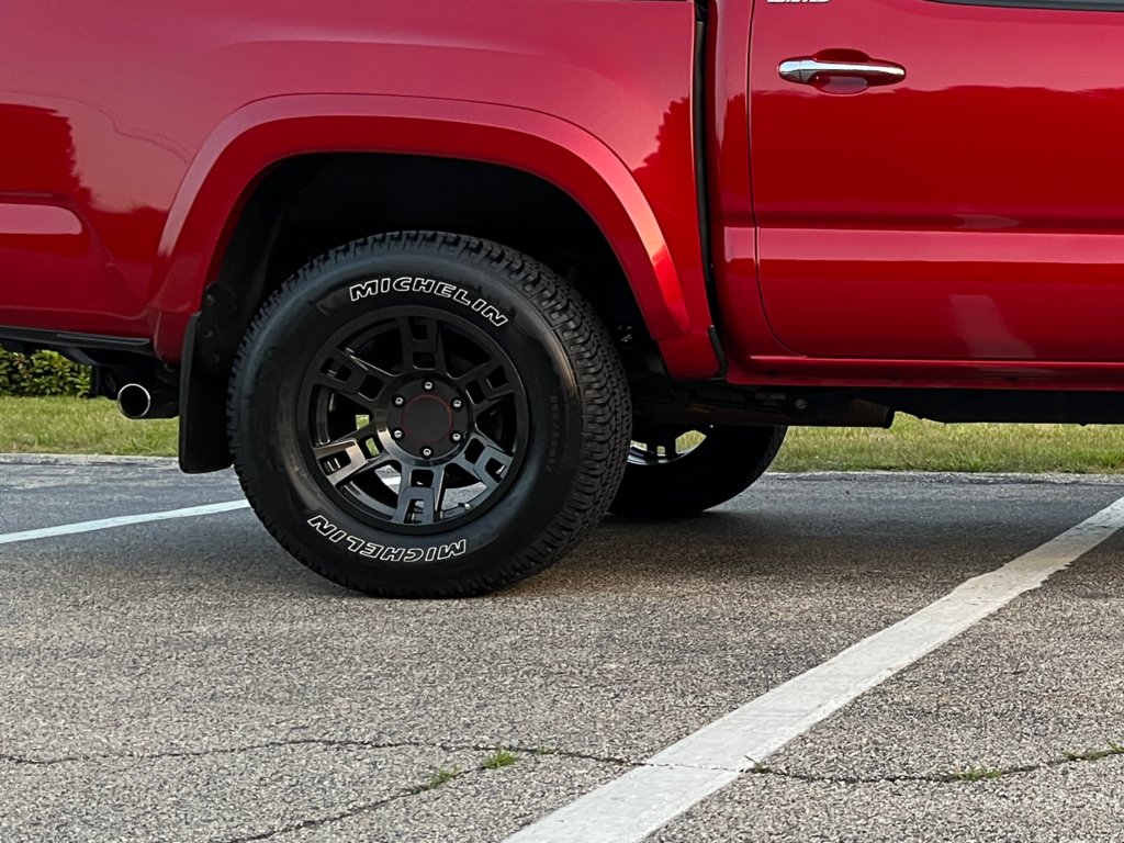

    19' Limited 4x4 (01' TRD OR, 97’ SR5 V6, 88’ SR5 Extra Cab)
    I have 265/65-17s on 8 inch wide, zero offset. Plenty of clearance. Same size as 265/60-18 I took off. IMG_0227.png

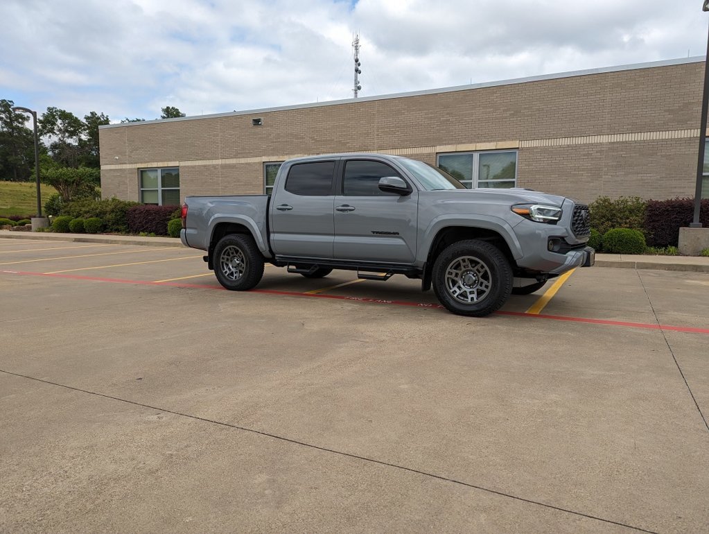

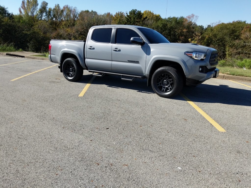

    2024 4Runner Off-Road
    265/65/R17 is the stock tire size on the 2016 - 2023 Sport.
    Ran SEMA TRD Pro wheels with that tire size for several years on my 2019 Sport and 2020 Sport without speedometer/odometer issues. Don't see it causing any for you either.
    2020 Sport
    2019 Sport
