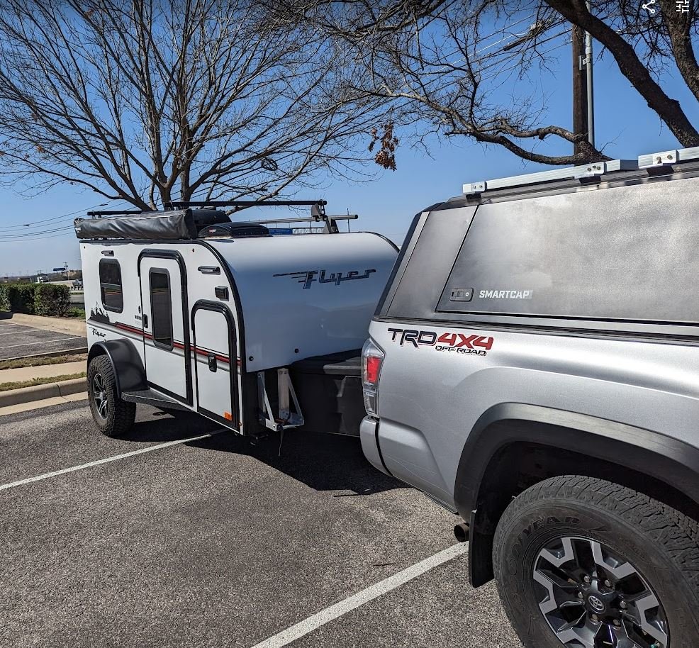

    What size toy are you hauling?
    Take a look at the Intech Flyer Discover.
    https://intech.com/rv/models/flyer/explore/
    All aluminum frame/structure helps reduce the weight.
    Tongue weight gets subtracted from the 950-pound load capacity. I'm running sliders, caps, and skid plates, leaving 550 pounds for tongue weight and gear.
    Wind resistance is the biggest concern, but with the Tacoma, I went with its little brother, the Pursue (41" interior height, Velomobile fits, or I can sleep in it). Aluminum, decent ground clearance. Width of the Tacoma so I can see behind me when towing. It tucks in the slipstream of the Tacoma, so you don't realize it is back there when towing.
