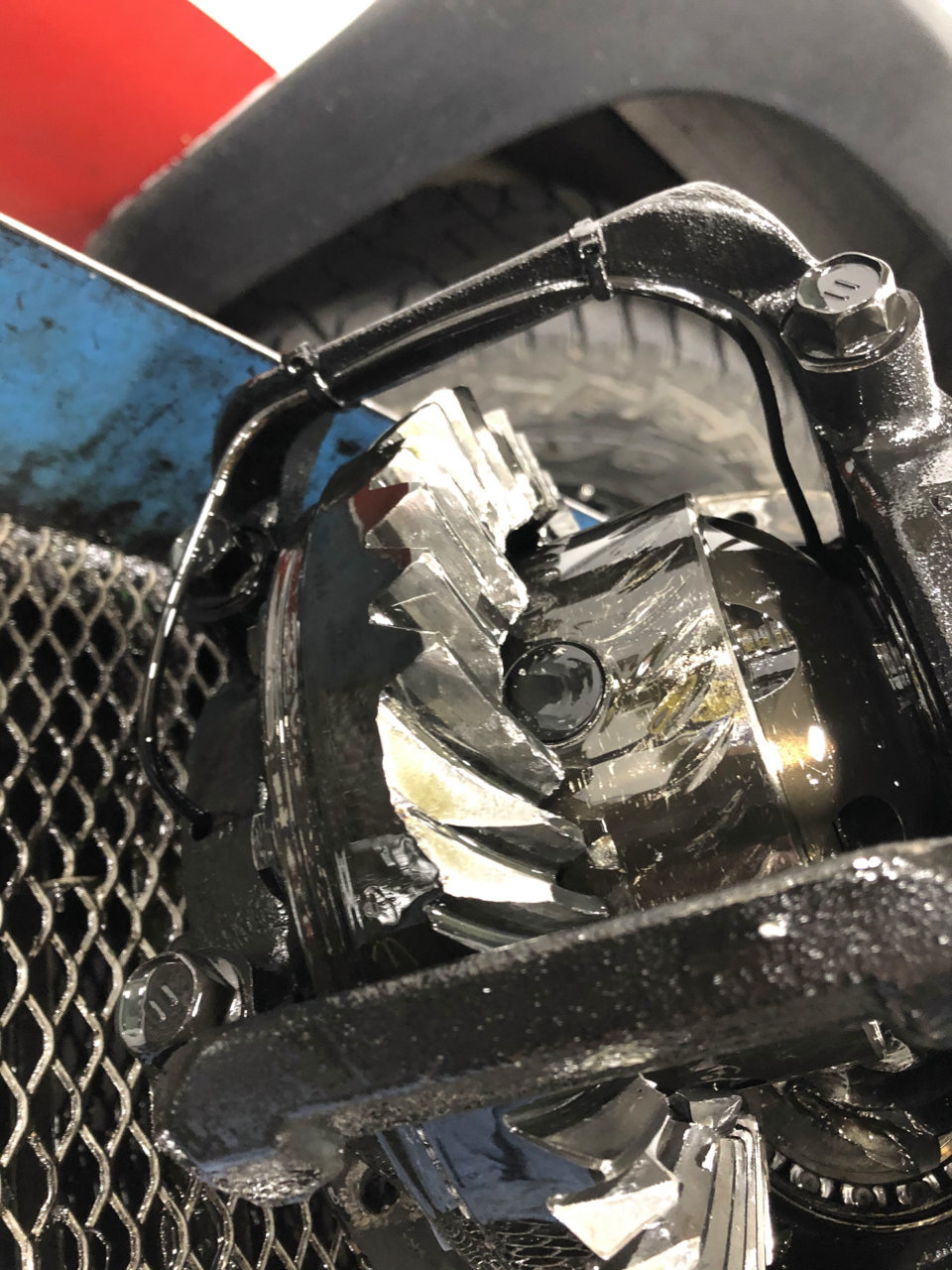

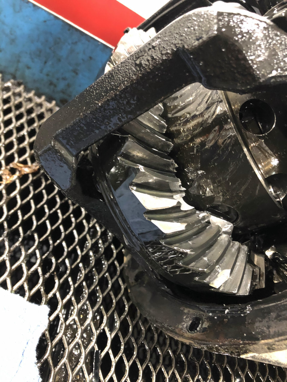

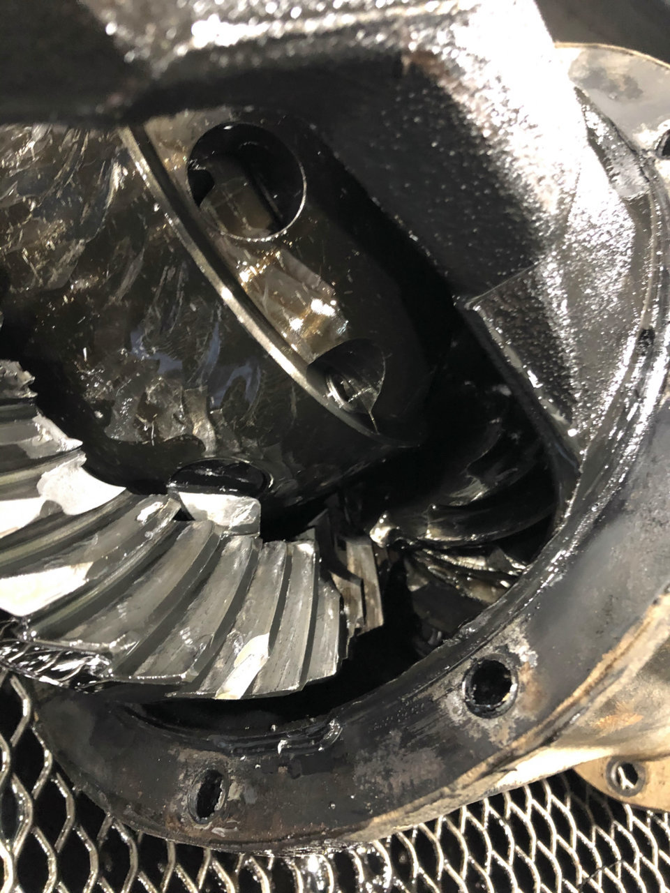

    Guess I owe this thread some closure. Thanks for all your inputs, recommendations and offers to help.

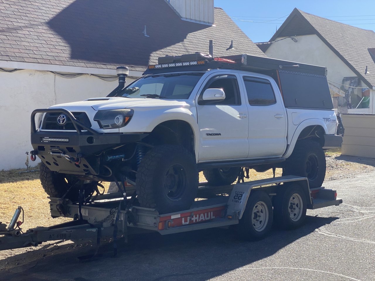

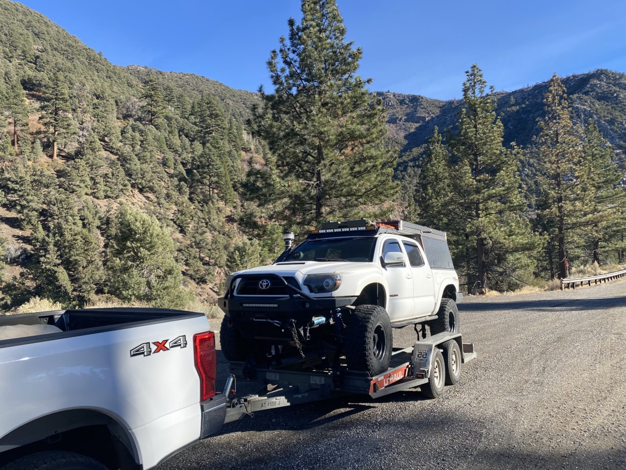

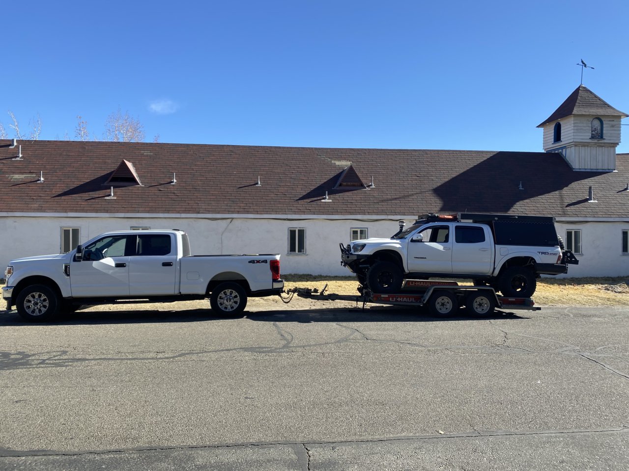

    First thing I have to say is that Kyle at the Bishop Enterprise is right up there with Satan. Ended up returning to bishop the next day and getting another rental car to drive home .
    Came back the next weekend with a rental truck and a uhaul trailer.
    Pulled the rear apart once I was back and found, the spider gear was in real rough shape.
    Luckily the airlocker was spared and it only cost me a set of gears and not more. The wear pattern wasn't so good on the gears so I imagine they'd been in not great shape for a while here.

    I drove 5 hours out to Mammoth the day before this happened, no noises whatsoever. When it initially started, I had been offorad in 4 low and just got back on the road, I just felt a slight vibration that worsened with speed. By the time I got it apart, I had loaded and unloaded it from a trailer 3 or so times which I imagine only made the problem worse as I heard some pretty heinous noises.

    Right... Now I'm not sure if that was a result of the teeth braking off and potentially displacing the pinion in the first place or maybe something that happened first. I assumed that a tooth broke first which caused the other effects.
