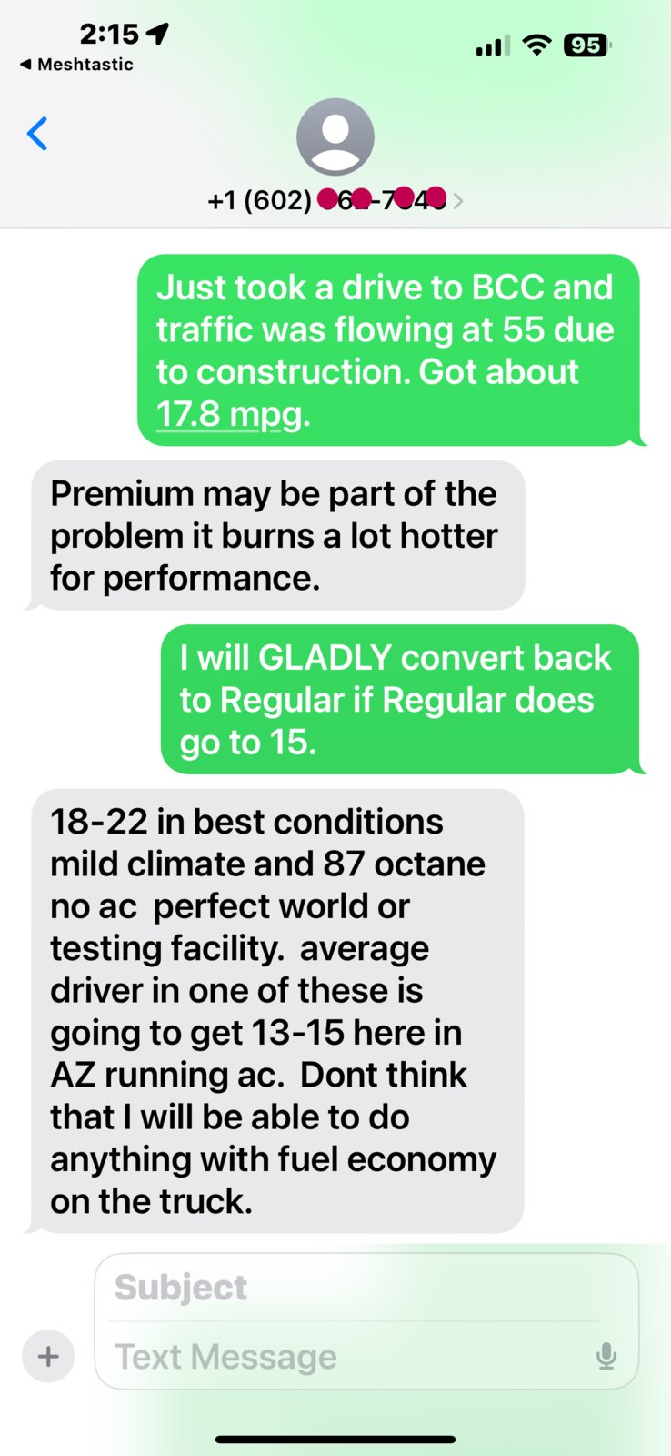

    I bought my truck at Bell Road Toyota and it is the closest to the house. So that's where I have been going for service which has been two oil changes and the rear axle welding spater recall.
    But I have also asked for them to check the transmission fluid twice and they have declined.
    And over the last 5,000 miles I have had a drop in MPG into the 15/17MPG range. Have tried all 3 grades of gas and drive like a grandpa. They have now declined to check out the truck for that as well too. Tech says using premium gas is my problem and that I should be happy with 13 to 15 MPG on stock tires.
    Three up three down end of an inning - time for someone else to be up at bat. Not Bell Road Toyota. Is Camelback any good? Any other Phoenix Area recommendations for Genuine Toyota Service?

    He does have a point with the A/C. My daily has dropped about 3 mpg since it hit triple digits.
    Premium gas causing the problem sounds like he's been huffing the fumes, but not sure why you'd be running it in the first place.
    My understanding though is third gens average around 18, but it's really going to depend on traffic conditions. My rule of thumb is accelerate ~60% throttle, decel/coast as soon as possible. As strange as it is I've found oscillating by 5mph once at speed (eg: hit 55, reduce throttle so you have a tendency to slow down to 50 over the next 30 seconds, then accelerate to 55 again slowly) gets you better mileage on any car/truck. High gear is your best friend.
    Sorry I don't have a new servicer recommendation for you. I'd quit pestering that dealer about your mpg problems though. If you're out of warranty I'd probably stay away from any dealership.

    I agree with Trey above about asking about fuel grade and MPG to them. They don't know shit.
    Your gas mileage is terrible though, especially stock. Start researching why that could be happening, generically (i.e. not Tacoma specific). I don't agree with Trey above on the whole 'gas, coast, gas, coast, gas' driving style. Sounds like a miserable experience for his passengers, and for people driving around him. Accelerating at 60% throttle too sounds extreme. I bet I get off of the line at maybe 25% throttle.

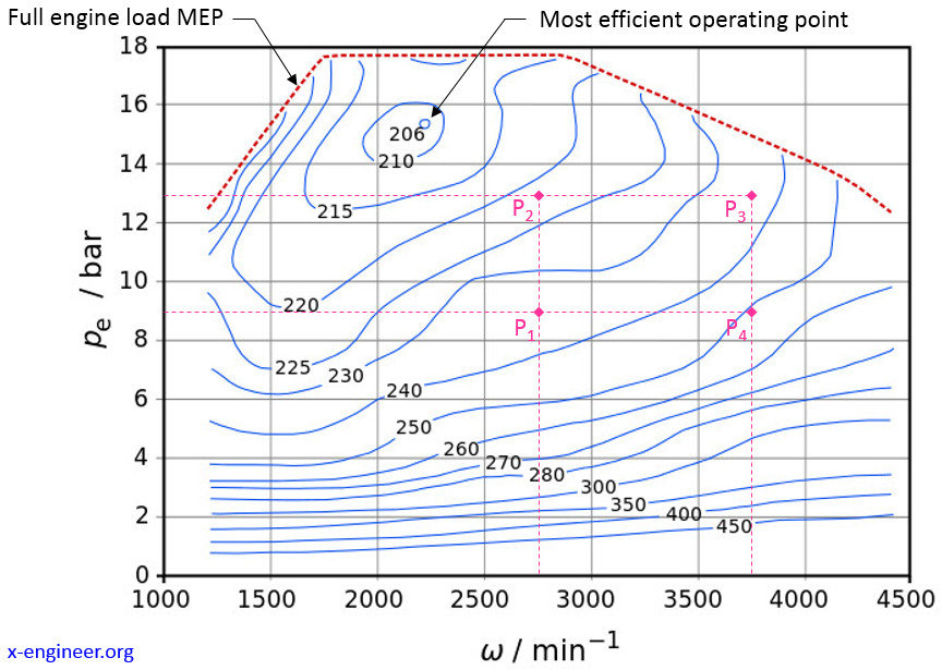

    I'm not sure what you read but it doesn't sound like you followed it all the way to it's conclusion.
    Throttle position is closely related to engine load (in fact you have EFI control built around this model in some cars), so while it is not in a BSFC map, you can make the relation.
    Think about the alternative to what you are saying: you think engines operate at one efficiency level at all operating points and torque produced is perfectly linear to fuel consumption? No.. Otherwise why not rev to 8k in every gear at a low throttle? You'd be using a tiny bit of fuel a bunch more times, but it wouldn't matter by your logic.
    There is a "most-ideal" operating condition for any motor. It doesn't matter what your torque *requirement* is, you have a spot where you will make the most torque for the least amount of fuel. And what I'm saying is you can use gearing and throttle to try and force yourself closer to that spot.
    Something like this is what I'm referencing (ignore the y axis units):
    also decent video
    https://www.youtube.com/watch?v=iNspNdVkslA

    There must be a massive disconnect between what we are sharing with one another. I'm either a terrible explainer, or you're purposefully being obtuse in an attempt to make your viewpoint the correct one.
    In any regard, I digress. You continue to drive around at 65-85% throttle and do you.
