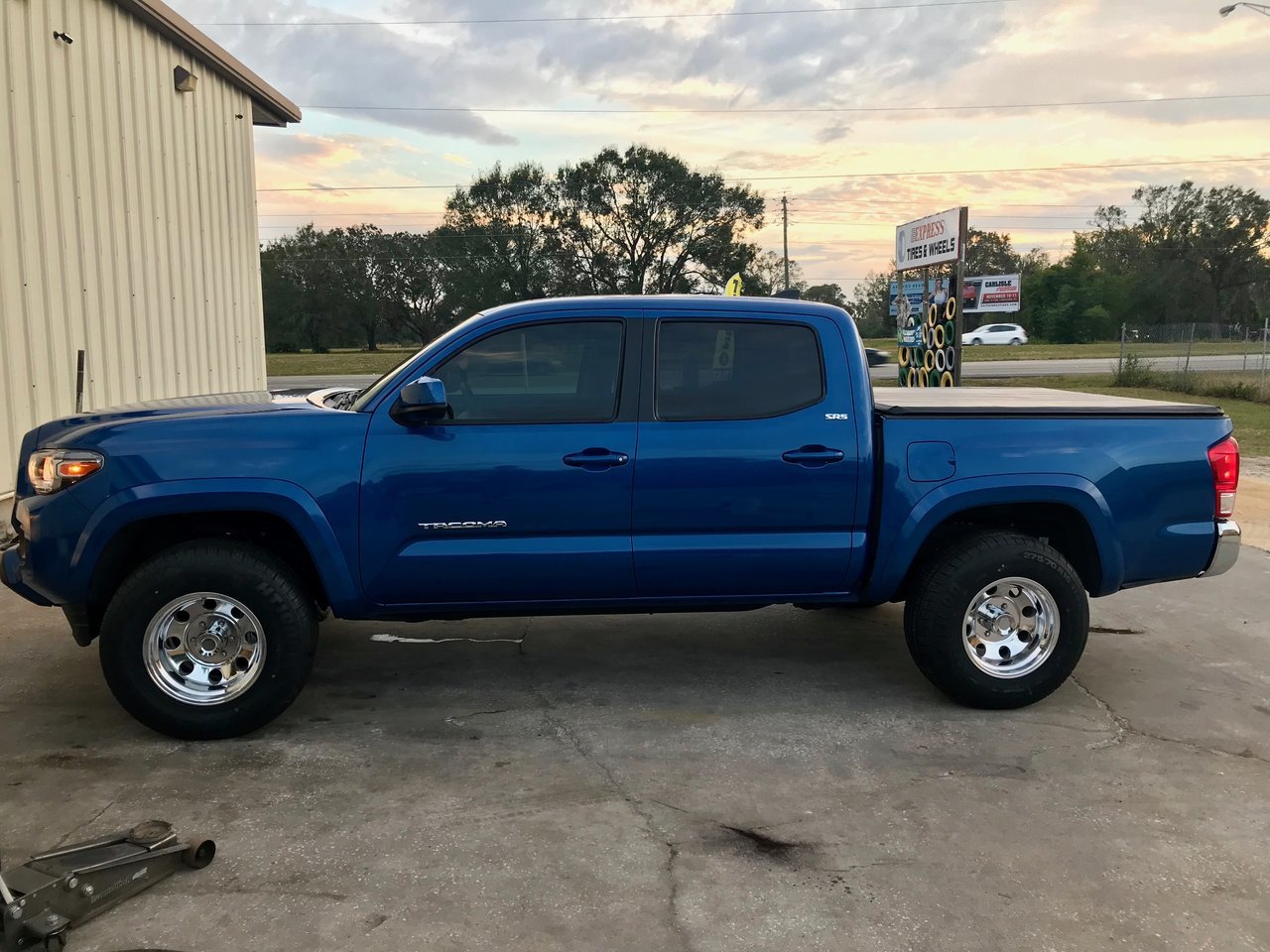

    heres mine with 265/70r17's. I want bigger to fill the wheel wells a little bit more. IMO they can look a tad small on my OME 2-3" lift. I rubbed during partial lock and compression entering steep driveway entrances when I was stock on this wheel and tire set up. Might have been fixable with a better alignment but no issues now with the lift.
