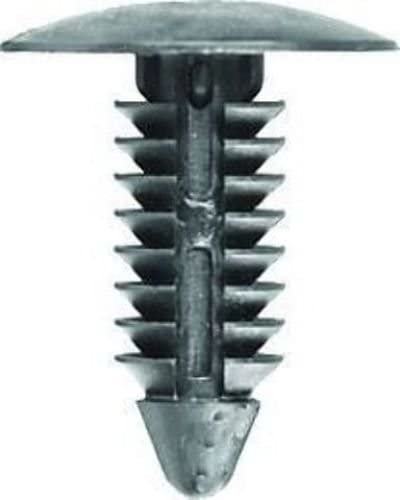

    I think I'd stop by an auto parts store and pick up the right sized plastic trim plugs and push them in. They wouldn't be invisible, but, they would look like they were supposed to be there.

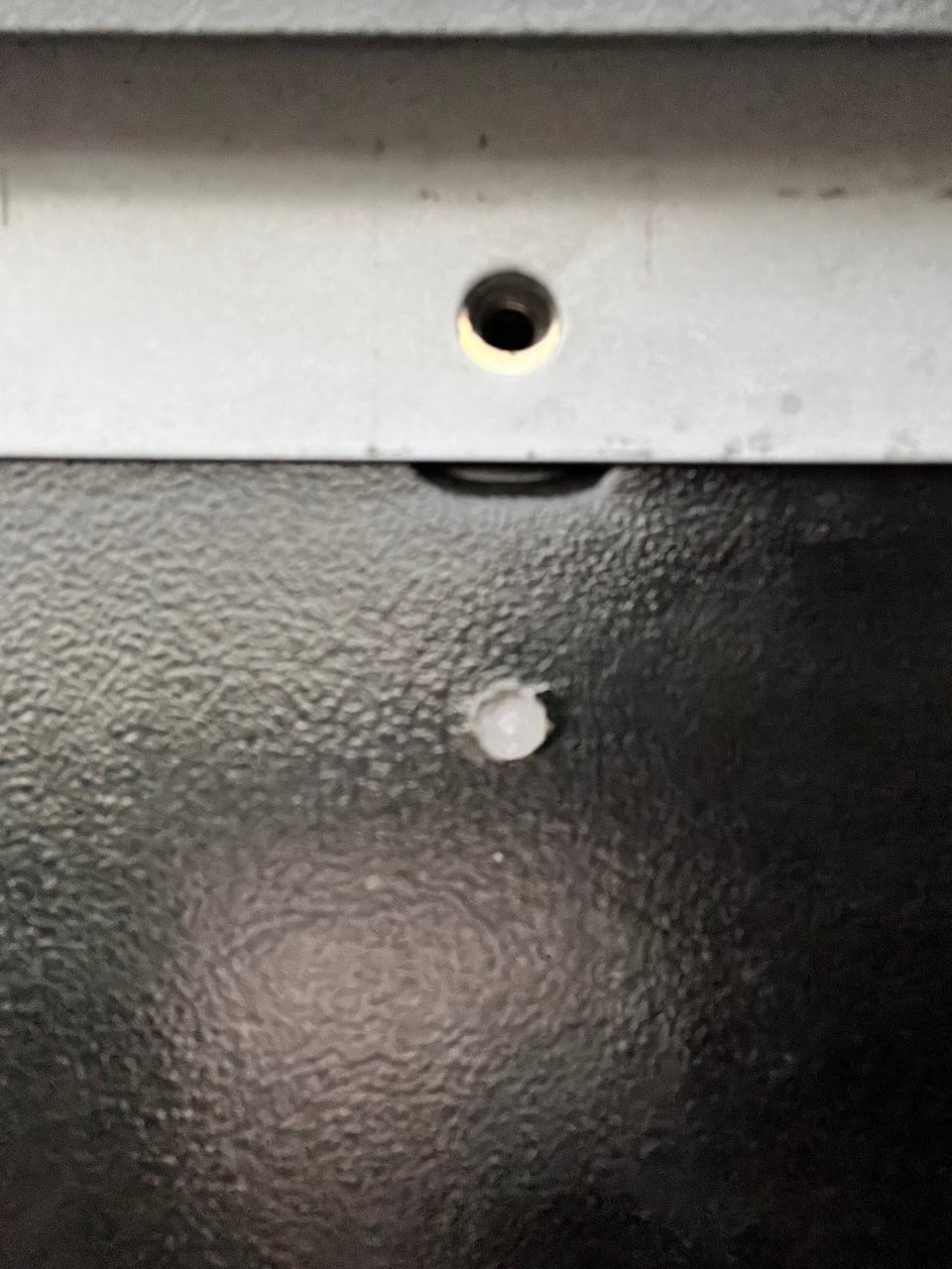

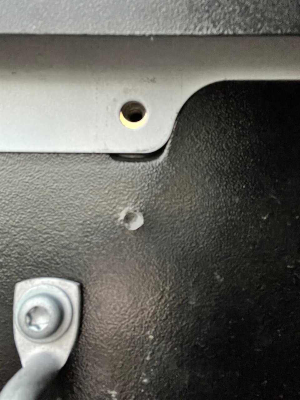

    There are four holes, evenly spaced along the upper portion of one side of the bed. These two are the largest. The angle and lighting makes it look like they are not through-holes, but they are.
