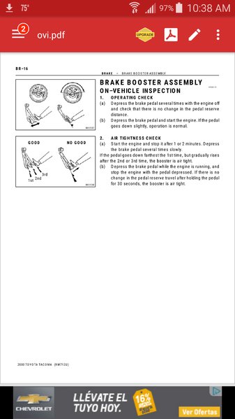

    Definitely doesn't seem to be many posts about them going out. I had one fail on an old 76 Land Cruiser and that's all my experience with brake boosters entails.
    Here is an image of the on vehicle inspection process from the FSM for a 2000 taco. I imagine that it's the same for all first gens, being that they share the same booster.

    Negative. 95-00 tacos have a dual diaphragm booster with a 1" master cylinder, similar setup to a T100. 01-04 models have a single diaphragm booster with a 13/16" MC. The MC and booster are not interchangeable between the two setups, you either need both from one era or both from the other.
    The inspection procedure for the booster posted above is the same for all power boosters of all types.
