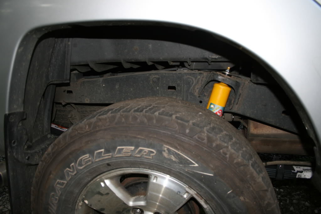

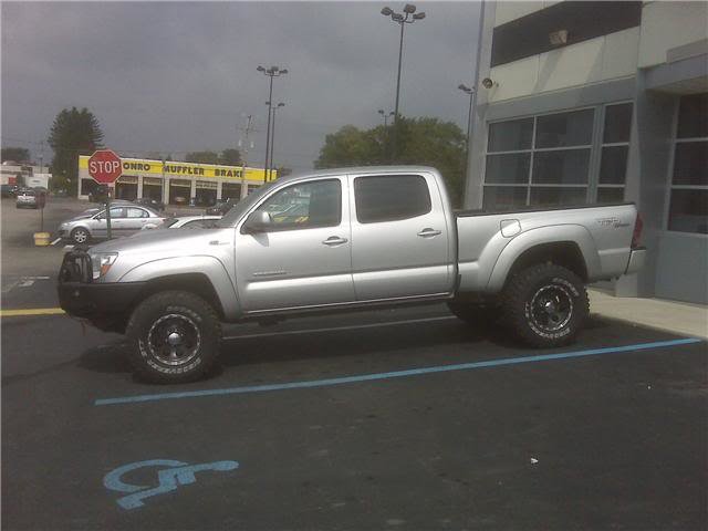

    This is the (Old Man Emu) OME 885 Springs and OME Front Struts I put on a 2010 Tacoma 4x4 Dbl Cab LB TRD Sport. They lift it about 2-3/4" up front. If you want more add the top spacer they offer from toytec. It's about 1/4" thick, but adds 3/4" in lift. Best place to get good deals I was able to find is: www.trdparts4u.com

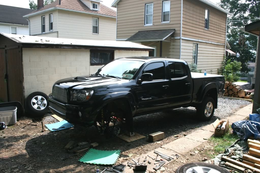

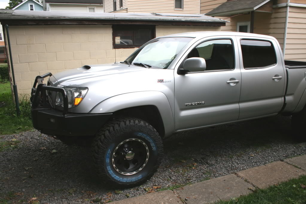

    I have about 35,000 miles on my Silver Tacoma since I put the OME 886 Springs and OME Struts. No ball joint problems. Note: OME 885 springs are good if you have no added weight to the front. I used the OME 886 springs because I have the extra 300lbs with the 200lb ARB front bumper and about 100lb T-Max 10k Winch.

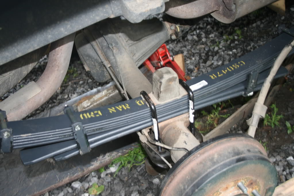

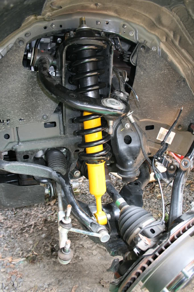

    As you can see, No need to change the upper control arms with 3" lift, but I do agree if you buy new rims, get a 4-1/2" back space (4.5" BS)
    Also the Dakar rear leaf springs give a good 3" lift in the rear.
