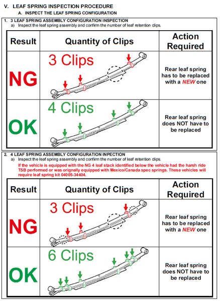

    No, that is not true. The recall requires clamps in certain areas. If they are not then the recall applies.
    Look at your springs with respect to the below. If you have 3 clips you qualify. If you have 4 clips as below you do not.
    This is the criteria from the recall remedy document:
    Updated information as pointed out by xJuice

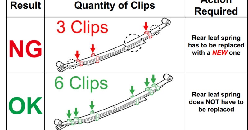

    Ok thanks. I checked with the service manager just now and he said that my truck leaf springs has 6 clips since I already had the harsh ride tsb done. so I should be ok and no recall is needed for me ?

    Deleted as I was wrong... there are 6 clip springs... :oops:

    That is just the 3 leaf inspection.
    Here is the full page.

    I stand corrected on the six clips etc... :oops: Thank you xJuice very much for the correction.
    That is what I get for only reading half of the recall.
    I would however still look for myself. Why did they say at first he was qualified? They must have only checked the VIN the first time.

    The dealer was right in my case. when I took my truck for the harsh ride tsb few years ago, they replaced the leaf springs with the leaf springs that had 6 clips on each. so mine does have 6 clips. so they didnt change anything. What bugs me is that I took my truck there 3-4 weeks ago and they confirmed that i was eligible for the recall. I bet that mechanic didnt even check how many clips my truck had.
