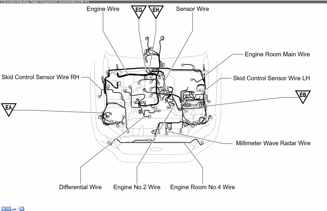

    Something isn't right. Can you post a photo with the points you are measuring? Engine off and Engine running, any change in voltage measured?
    Are you in Texas or another high hot area? Unfortunately, I find our heat kills batteries.
    If you get 13.65 Volts between terminals, you should still see 13.65V with probes at the body with no current draw. What's your outside temp?
    Often measuring at the body, you have an oxide layer on the top of a bolt or body, so I "scratch" with the probe to get a good reading. It's easy to get confused wondering what the heck is going on, but the probe is not making good contact. It helps to have a good meter (I use a Fluke). I had a cheap meter I tossed into the tool bag, but it gave me different readings. It turned out I needed a new 9V battery, so two meters to double-check when I am in the shop.
    Do you have a stereo amp, lots of lights, other add-on things? Or just an absolutely stock setup that looks like the day you rolled off the showroom floor?
    "EB" is the chassis ground point near the battery. "EA" is the point near the airbox. Engine Off, All loads off, you should be able to measure the same "ground" potential at all four ground locations when going from the positive terminal of the battery. On 15+ year-old vehicles, I've seen enough corrosion to cause problems, but more commonly a five-year-old Toyota is just a layer of oxide, hence needing to scratch a little to get a good reading.
