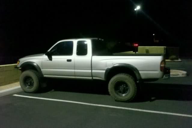

    havent been with my truck for a while and now that shes back in my life i need to buy her something so im taking care of her rear first
    got a friend who is helping me with the bedcage gonna look similar to this but with a traditional tire carrier
    now im planning on doing sua with some deavers 12in shackles and some 16" resis
    my tires are 265 and im not looking for a lot of extra lift from where it is now
    what are my best options for a rear sua setup that wont result in too much lift than this
    thanks just wanna make sure i get this right the first time

    You got it all pretty much right there. Deaver F67's with a 12" shackle over the frame, simple bed cage with some 16" shocks and your good. Thats exactly what I have if you check my build except I have a pair of 18" SAW's I got used from a member here
