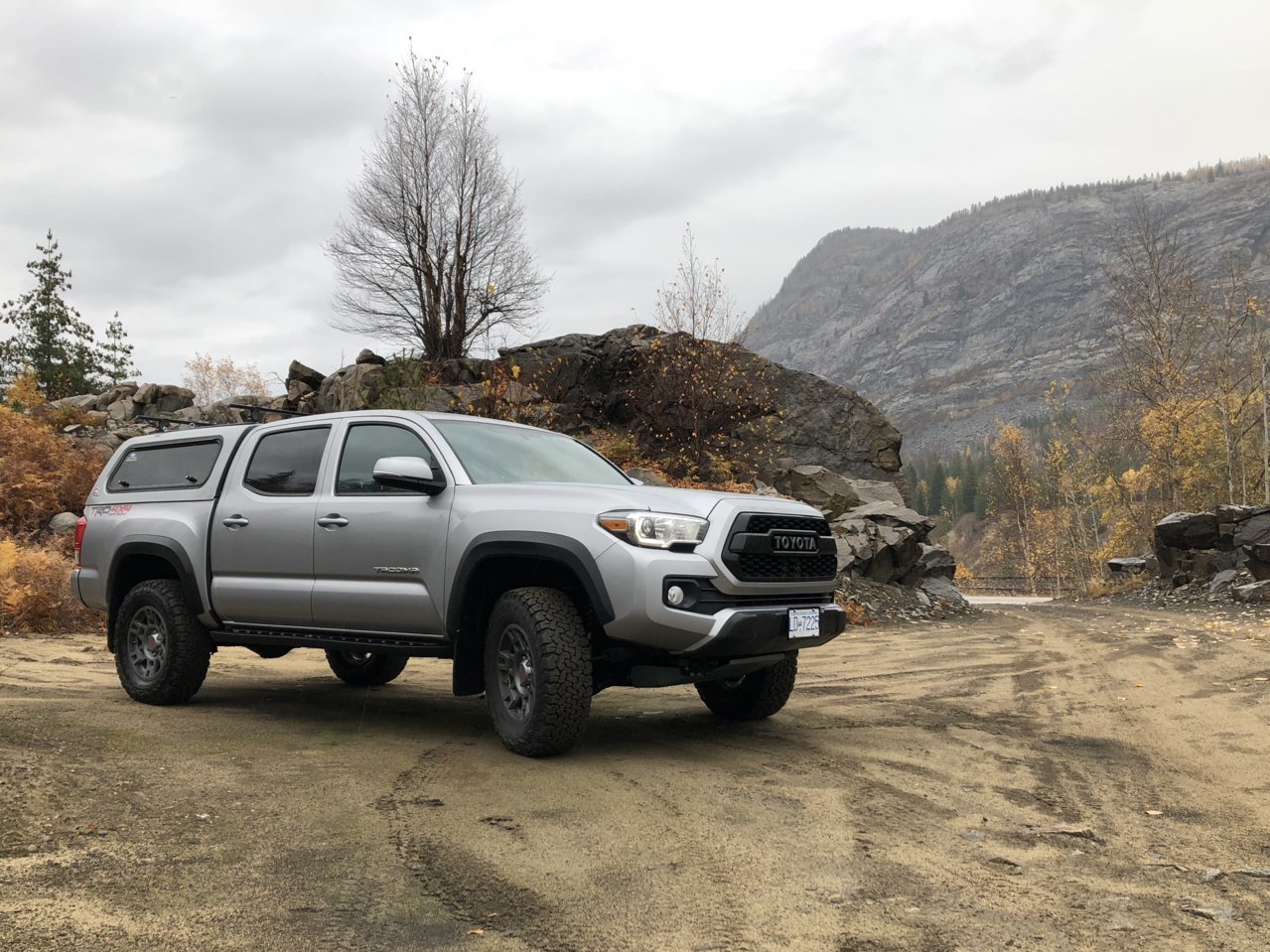

    May 31, 2018
    #255060
    782
    2017 DCSB TRD OR 4x4 MT
    You can get high end suspension without lifting it. That’s what I did. No CV/alignment/carrier bearing problems for this dude.
    Montanafreak[OP] and Paul631 like this.
