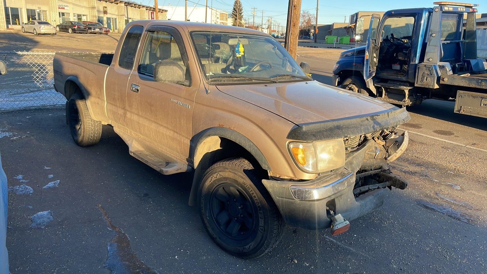

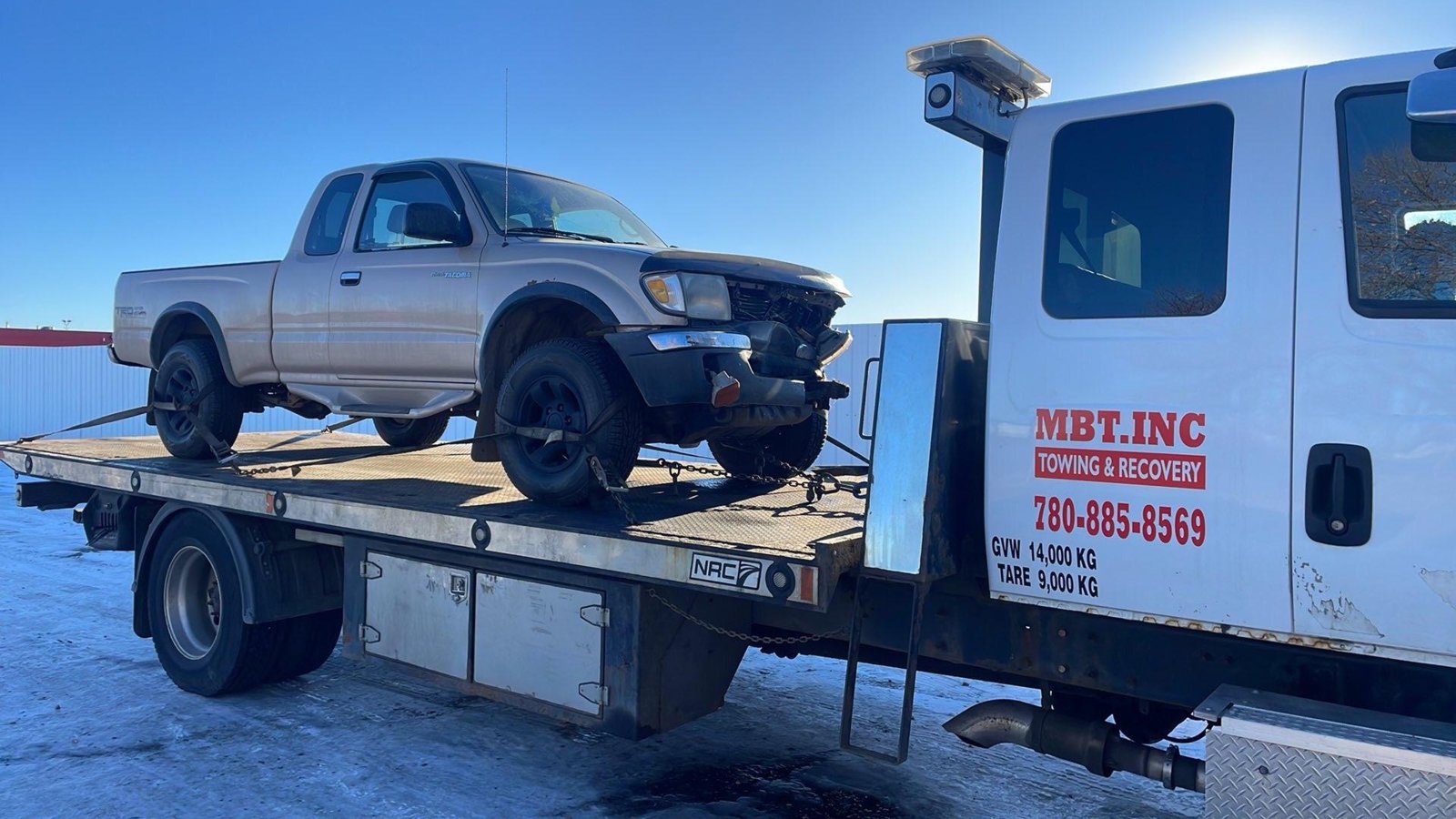

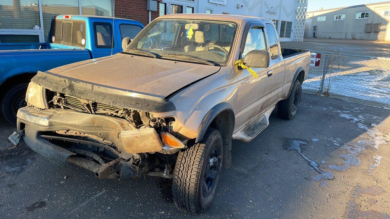

    I had a run in with a 4 legged mammal on the highway and caved in the front end. Truck was only 100k miles and had alot of sentimental value (grandfather owned it previous). I'm ready to take on the rebuild process and whatever costs and tribulations it entails (even if its totalled 3x over). But one aspect of repairs I have no experience with is frame damage. Does anyone know or have any experience on how to look for a bent or damaged frame, particularly on these 1st gen tacomas?
    Thanks in advance.
