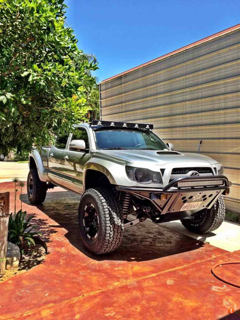

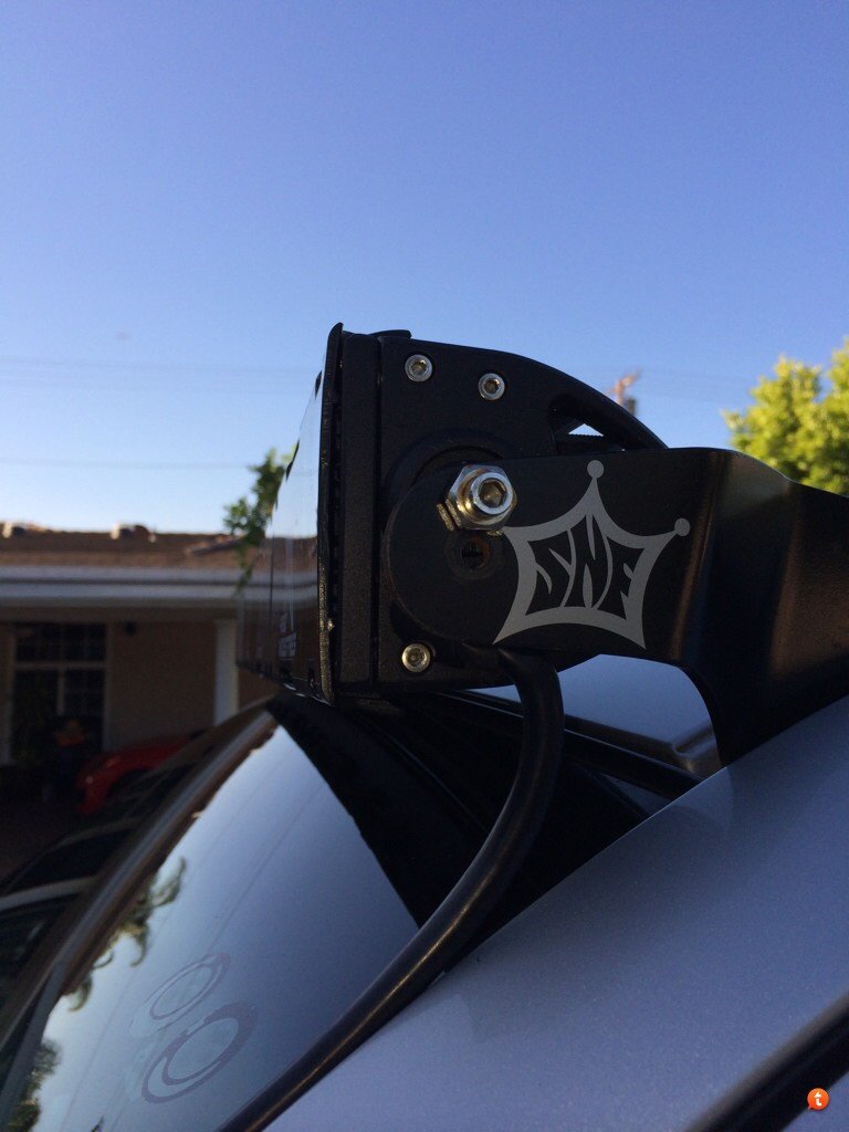

    Yea I have it bolted to the roof with brackets
    You can see the wire running down the windshield ^^^^
