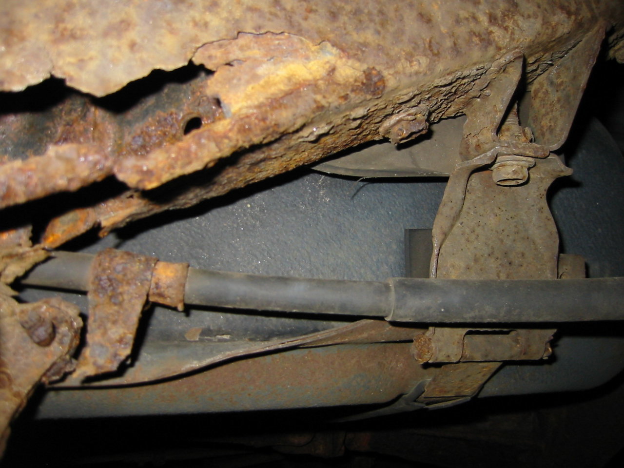

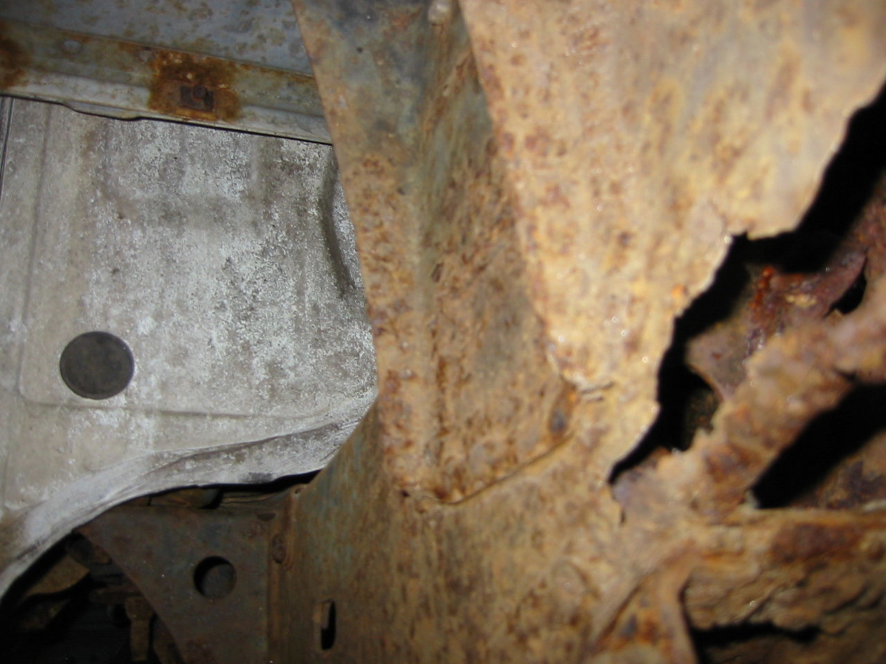

    It does seem like the green area is the bad area is that normal, I have to look again IMG_2052.jpg IMG_2046.jpg and will the mech need to remove the gas tank to I assume weld the parts together, or are they bolted together?
  8. Oct 19, 2020 at 8:31 PM
    oldguy128
    oldguy128 [OP] Well-Known Member
    Oct 5, 2013
    #113935
    172
    GARY
    Southbury CT
    1996 Toyota Tacoma

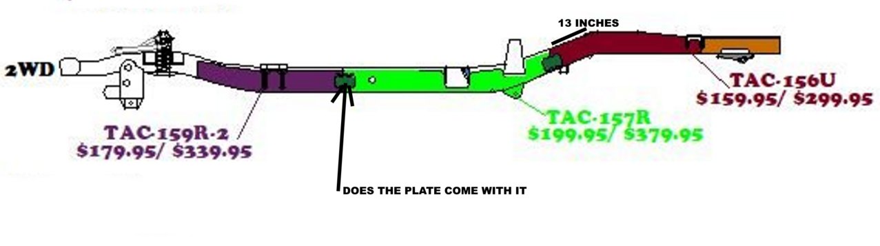

    Asking based on the pic if I should only have the GREEN are replaced or what for sure I want the green area on the other side done

    Judging by the pix I would hammer test every square inch of that frame before deciding to try to save it.

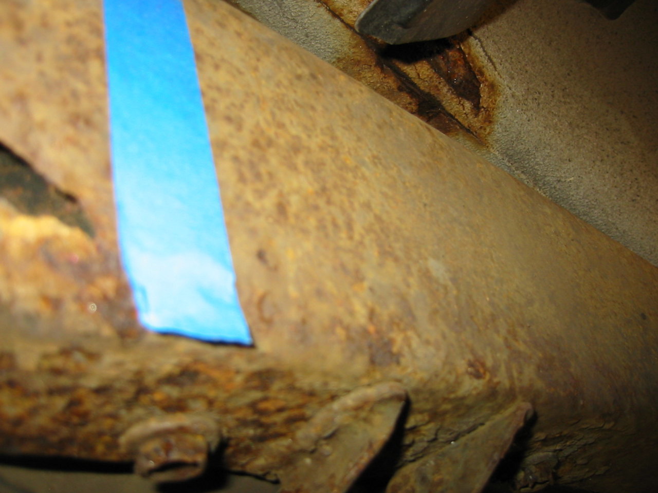

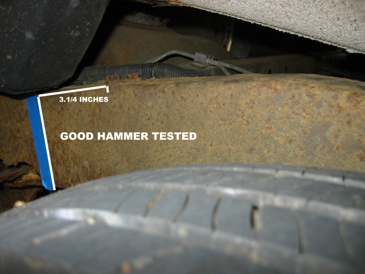

    OK, I checked the frame my driver side is bad, but I will also replace the TAC.157R on the side, I called the place got a nice girl on the phone now I need more help before I get the parts I asked her and she made it sound like it does not come with short plates for welding that section in does it, or is that extra she does not know about?
    Now the hard part I took pics of what is good do I need to buy the part for my driver side that goes behind it TAC.156U from the blue tape edge it is rock
    Hard, maybe even more towards the tape, but 100% sure from that edge can someone tell me from this info if I need it or not my Mech is very hard to
    Speak to over the phone his English is bad, and my Portuguese is not very good, but I do know at least 300 words, he's Spanish, but works for a Big body
    shop who is Portuguese and he understands Portuguese
    So he said bring parts I fix
    I will ask him to replace my rear bumper too and ask him if he can do shocks for it I will ask if he can cut the rust out of the bed near the bad part of the frame too and patch it
    I would sell it, but this damn COVID has me scared running around meeting strangers now who may just kill me, I have so much wrong or I bring it home
    and kill my wife who is very frail I will be 79 in a few days
    If you want to see me, here is a video I made to remove the bamboo https://www.youtube.com/watch?v=EyVBkG6mWns

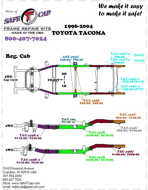

    Very hard to judge from pic if the green section is all you will need. Also unclear by your wording if both sides need to be capped. When you buy 2 or more sections that touch ends the splice plate(s) are included.
    That company is in RI. and have been repairing frames since before they started making the DIY kits.
    Is it possible to drop your truck at their RI. shop and have them do it?
    Considering the language barrier and good reputation of Auto rust repair co. It may save you in the long run.

    Nay, once I'm near him we can understand much better than on the phone, it's like all languages, crap I didn't even speak English when I started
    school, that part never scared me, I find most Spanish and Portuguese as good craftsman who take pride in their work
    And it's 2.5 hours away, honestly, my frame is so bad I doubt I could not make it, plus I don't have a way to get back short on family and friends
    My guy is good, he's done work for me two times before
    And I saw what he did for other people well since it is hard to know for sure I will order the green one, then measured it, and see if it butts up to the good
    metal, if not, I order the next part back and
    My only reason to have the other side done is it will go next since that section seems to go, it's solid now, but
    looks like it may go bad in a year or two, DO YOU AGREE, OR I'M I WASTING MY TIME??

    Sounds like a good plan :thumbsup:
    After I welded safe t caps on I sprayed in side the box frame with Coroseal and brushed it on the rust outside.
    Top coated with black Rust-Oleum.
    I keep my frame soaked in Fluid Film inside and out now.

    OK, I got the midsection only parts with the metal weld-on plates
