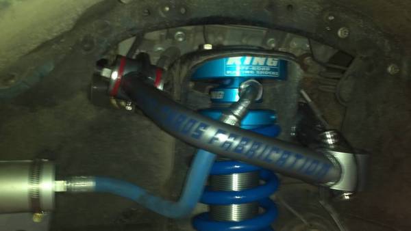

    Ive tried adjusting my c.o.'s wity no luck which sucks when you take them off the truck and can't adjust them. I put the base in the vice like the instructions say but the whole body and coil turn now besides the base. What did you use to hold the top without scratching it up?

    You should be able to adjust them on the truck, just remove the wheel if clearance is tight and don't adjust with the spring supporting the weight of the truck. Try some penetrating oil or something similar on the top of the spring so the collar moves freely. Might need to add something to your spanner wrench to give it some additional leverage.

    Nope already tried that. You have to remove it cause the line for the resi keeps it from turning far enough for the next hole because of the way the designed the ring to lock.

    lol the thing they call a spanner wrench which is just a long punch.

    Yeah king has a wrench with a handle and a curved end, I think you would need that to adjust them on the truck.
