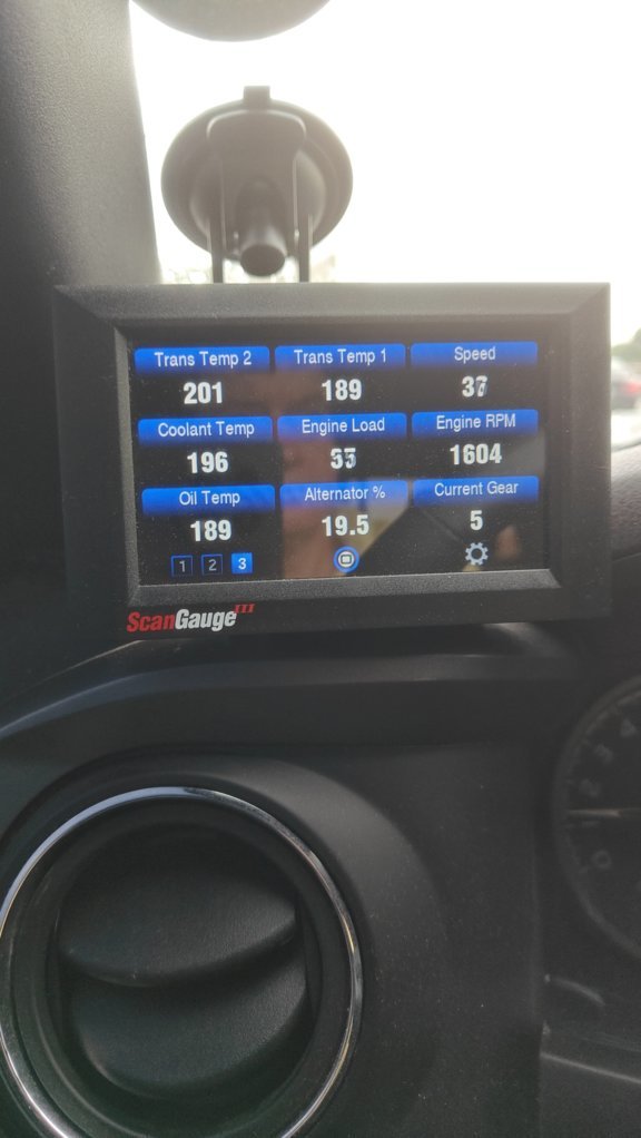

    I have a scan gauge 3 so i monitor everything alteady
