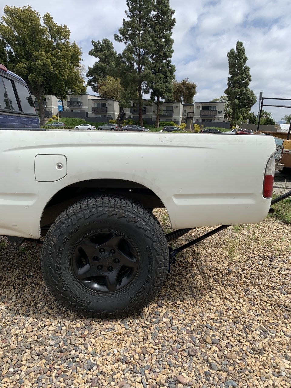

    Im gonna chime in since I am running a similar setup but going backwards from LT to MT in the rear. TC up front, old ass Deaver F67's, SUA, with 9" shackles mounted thru the frame. Sits nice and level, but doesnt do well with any weight whatsoever... Looking to go to a firmer pack and tucking the shocks under the bed.
    From my quick (not breaking down the leafs) measurements Im seeing about 11.25" travel with 1" tire to fender gap. Thinking I can squeeze a 10" shock in leaned back a bit with the mounts being about the same height as the leaf pack
    Pic is stock bed with no shocks for those considering height, 285/75/16
