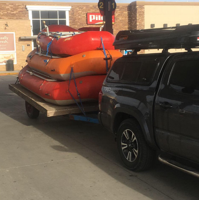

    I have an issue with overloading the stock suspension in the rear of my 2016 TRD OR. This happens in the summer on the highway when loaded with coolers and a trailer holding rafts. I don't often offroad but end up driving dirt roads or mild trails for river access frequently.

    Can anyone offer an opinion on the best way to address this issue. I don't want to continue to bottom out the rear when loaded with gear and towing a trailer. Here is a picture of a friends stock 2016 truck at the end of a recent trip (coolers and water load are MUCH lighter in this photo).

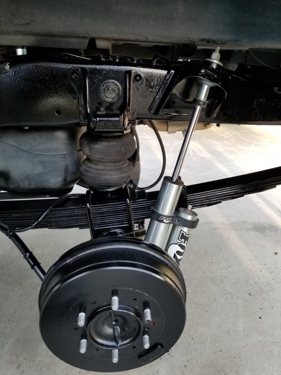

    Austin, TX
    2017 Tacoma SR5 4x4
    I installed airbags due to some rear sag when towing my travel trailer. The airbags do not increase load capacity (and I'm not overloaded), but they do alleviate rear end squatting. They also help a ton with 'porpoising'.
