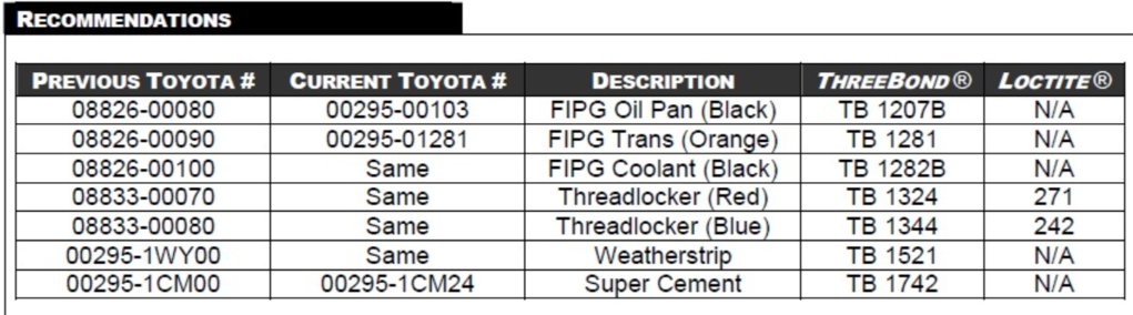

    For the gasket material, straight up Toyota trans pan FIPG (Part No. 08826-00090). I used it on the transfer case when I rebuilt it and also on the trans pan. No leaks and just followed the FSM. No issues.

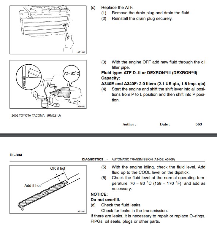

    FWIW, I had to order a new pan for the 99 T4R A340F I put in when I did my 4WD conversion. I used this - https://autoparts.toyotasalinas.com/products/product/pan-sub-assy-transm-3510635110. No issues at all. Regardless of what pan you use, just make sure you follow the fill procedure and you'll be fine.
    Fill it to the cold level on the dipstick. Once at the cold level, get in and start. Shift through all your gears and shut off the engine. Do another check of the dipstick (its going to be below the cold level now). Fill to cold level. Get in, start and shift through the gears. Repeat check with engine running. Once at cold level with the engine running, drive and get it up to operating temp. Recheck with engine running. Fill until its in the hot range.
    FSM fill in case my gibberish process is confusing lol
