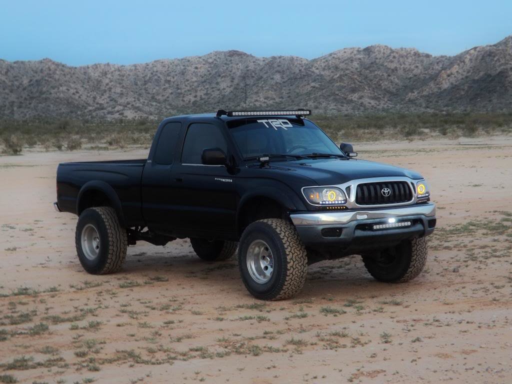

    Oh and here's a pic of her. I can take more detailed ones of the setup if need be.
