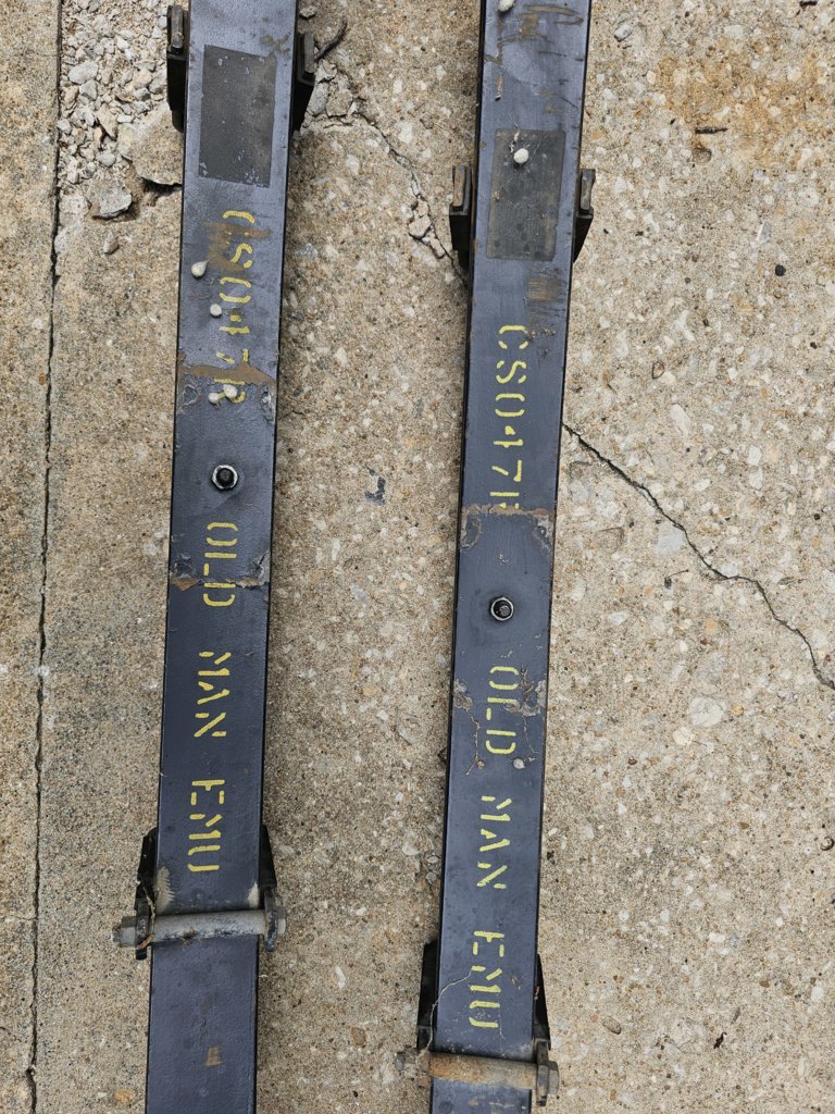

    I just I got an old set of OME springs installed. I picked them up used, prior owner had had them warrantied bc of paint failure. They don't look too bad but I'm going to keep them covered with fluid film to be safe20240526_130439.jpg

    I'm not sure fluid film is a good idea for leaf springs as it will attract dirt between the leaves, which will lead to friction and noise making it sound like matress springs on prom night.
    In my case I tore the leaf packs apart and am repainting them giving each pack a week to fully cure and likely some time in the sun before a good wet sand and slapping em together.
