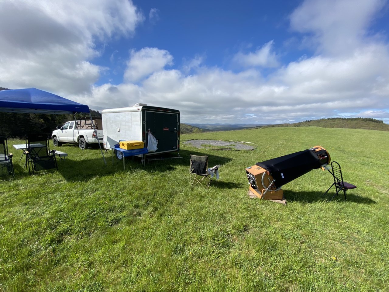

    That’s my trailer, scope and dog. When he was one year old he came down with an autoimmune disease that attacks the jaw muscles.He was on steroids for a year. He went from 97 pounds to 117, developed an obsession with food and is a wee bit overweight.
    He rides on a shelf over the jump seats.
