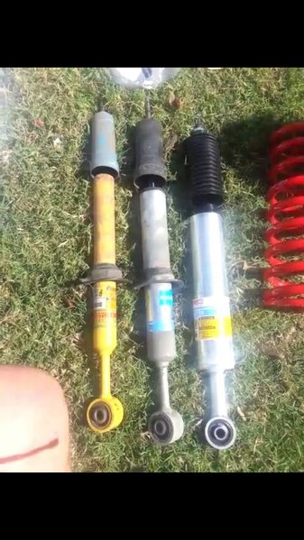

    Bilstein 5100s only if you want to lift the front a little. OEM take offs from a 2017 truck or Bilstein 4600HDs would be my recommendation for direct replacements for stock height trucks.
    Both will be cheaper than 5100s.
    Wouldn’t recommend OME shocks, after using them.

    OP has a tx baja
    '17 take offs and or 4600hd would be a downgrade from the struts his truck came with out of the factory...

    10-4.. didn't realize that was actually different than the other packages.
    Still wouldn't recommend OME, they're not worth the cost, especially over 5100s that behave the same way for less money and less noise.
    Looks like either choice is a downgrade from the factory Baja shocks.
    OME -> 5100 -> OEM Baja

    that is a 4600 in that pic, not an Old Man Emu strut.

    If you want to replace your OEM shocks with the direct aftermarket equivalent, then you need to get 6112 and 5160 set up. 5100/OME/4600 are all a downgrade.
