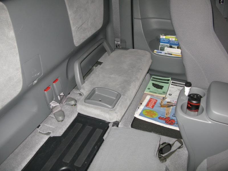

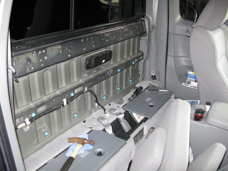

    Looks like I could easily bring that wire out the little hatch or from under the plastic cover.
    Here are some pics from another thread about removing the sub/switching out the back seats for a pre-09
    http://www.tacomaworld.com/forum/2n...ccess-cab-rear-seat-conversion-05-08-a-2.html
