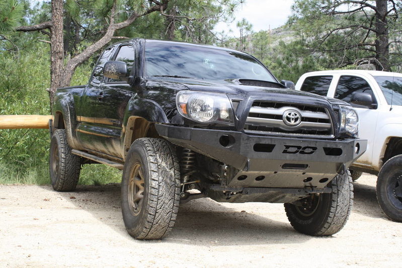

    3" lift, 33's; had to remove the mud flaps, do a CMC, flatten the pinch weld and cut some plastic near where the mudflaps mount. More you flex the more you will have to cut..

    Wow! Great looking rig. I've gotta say I've had a three inch with 33's on mine for years and haven't done any of that with ZERO rubbing or issues.
