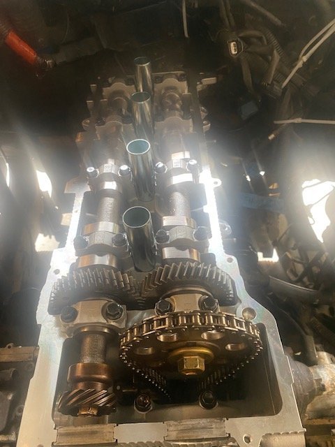

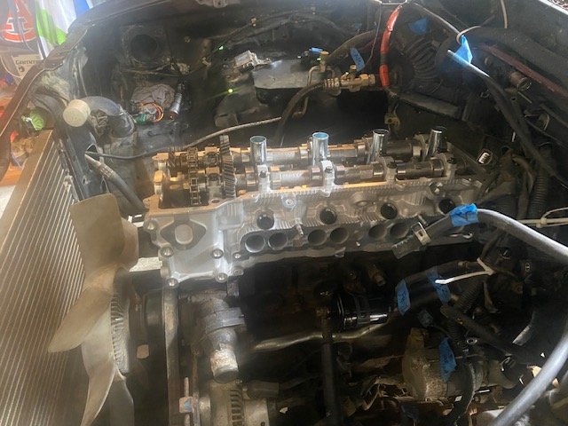

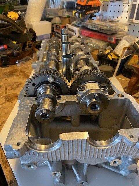

    So far so good. New head is in and valve cover is installed. Still need to bolt on the manifolds - I'm around step #17 in the FSM.
    Pretty straightforward (up to this point anyway).
    I opted to replace fuel filter, the 2 coolant temp sensors, and the thermostat. I'm waiting on the rear coolant sensor (arriving tomorrow) before I can put the rear cylinder head cover and hose on. That one seems impossible to reach, and I figured now would be the time to replace. Snapped a bolt installing the valve cover - it's odd to me there are no torque specs listed in the FSM or Haynes manual. I think it says something like "tight, but not too tight". Huh?
    Anyway, I'll update soon, hopefully. It's definitely taking longer to put it back together than tearing it apart. With limited time during the week, I hope to finish it up next weekend. Couple of pics below.....will keep yall posted.
