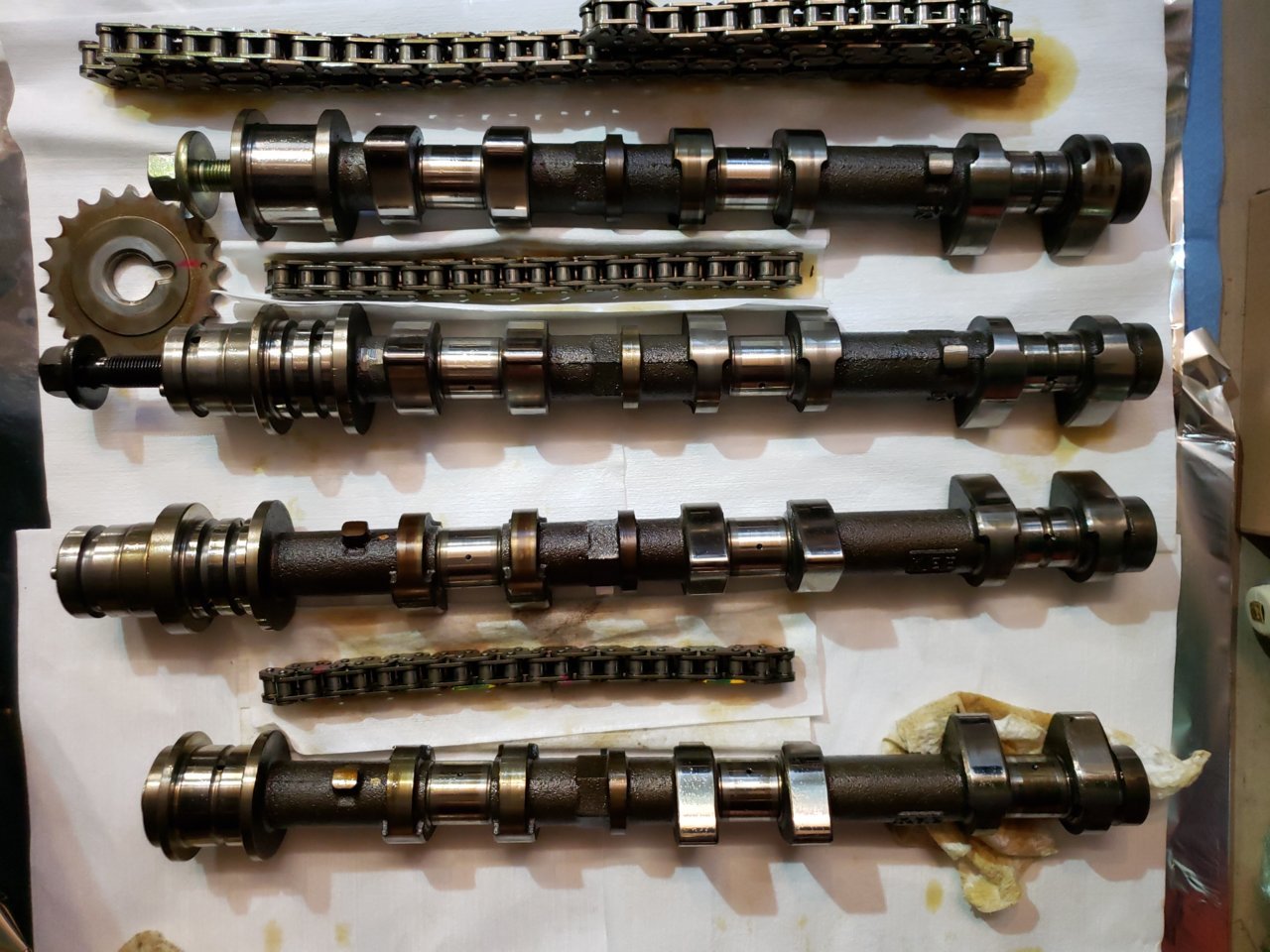

    I would replace anything that shows that much wear but I am sometimes overly cautious.

    TOYOTA OEM: Cast Aluminum Running Boards Mud Guards Bed Mat All-Weather Floor Liner NIssan Frontier Sliding Bed Extender
    I’m gonna take the heads off soon. If the heads are still within allowed tolerance I’ll probably fix it. If not I’m gonna find a used engine.

    I couldn't find photos of my cam bearing caps or whatever they're called. Here's a photo of the cams. I'd say yours look worse, but it could be as simple as different lighting conditions for the photos.
    I hope you're making progress on the head removal. I definitely recommend examining the oil and taking the heads/cams/etc to a shop for inspection before throwing in the towel on this engine. Maybe also the front timing cover -- look for signs of excessive wear on the oil pump. Was there a lot of sludge in the valve area?
    If the oil is clean, heads are straight, and wear is normal... then you can put the engine back together with the new head gasket, and it will be as good as any other 1GR out there. The '05 design defect was limited to the head gasket itself, and your new head gasket is the same as used in the '07-ups. Even if you decide your engine isn't worth repairing, since you already have the gasket kit and tools, I wouldn't shy away from a good deal on a lower mileage '05 or '06 junkyard engine and just swap the HG before you drop it in. It's probably not a hard job if you're starting with a long block on a pallet... although I've never personally swapped an engine or worked on one outside of the engine bay.
    Oh, and if the wear is superficial, you can carefully polish out the rough areas with a fine polishing compound or maybe emery cloth, and that might help reduce the future rate of wear.
    Good luck, and let us know what happens.

    The thing is that this engine already has 330k miles and the head gaskets have already been replaced once before. I can see the paint marks on the timing chain and head bolts, the VVT, crank and idler sprockets are below the minimum diameter and a new chain will be needed too. A valve grind kit, new timing chain and sprocket kit, and 2 new VVT cam sprockets is close to $1000. I found a used 70k mile 08 Taco engine for $2k yesterday. I will receive the head bolt driver tomorrow, I can still remove the head to disillusion myself.

    Oops I missed the updates regarding engine age and prior repairs. There's still a chance, but I would probably also be shopping for an engine. Hope you have some recourse against the entity you bought it from.

    With that many miles over 300k forget that engine u will have so many more issues with it
    Put ur money into a salvage yard engine much better off in the long run

    God willing I’ll get an engine. Found a decent 08 4.0 yesterday for $2k. I’m probably still gonna take the head off when I get the head bolt driver, prob tomorrow. Just to show you guys.

    The cams have no shells there really is no fix for that except to replace the heads and cams.
