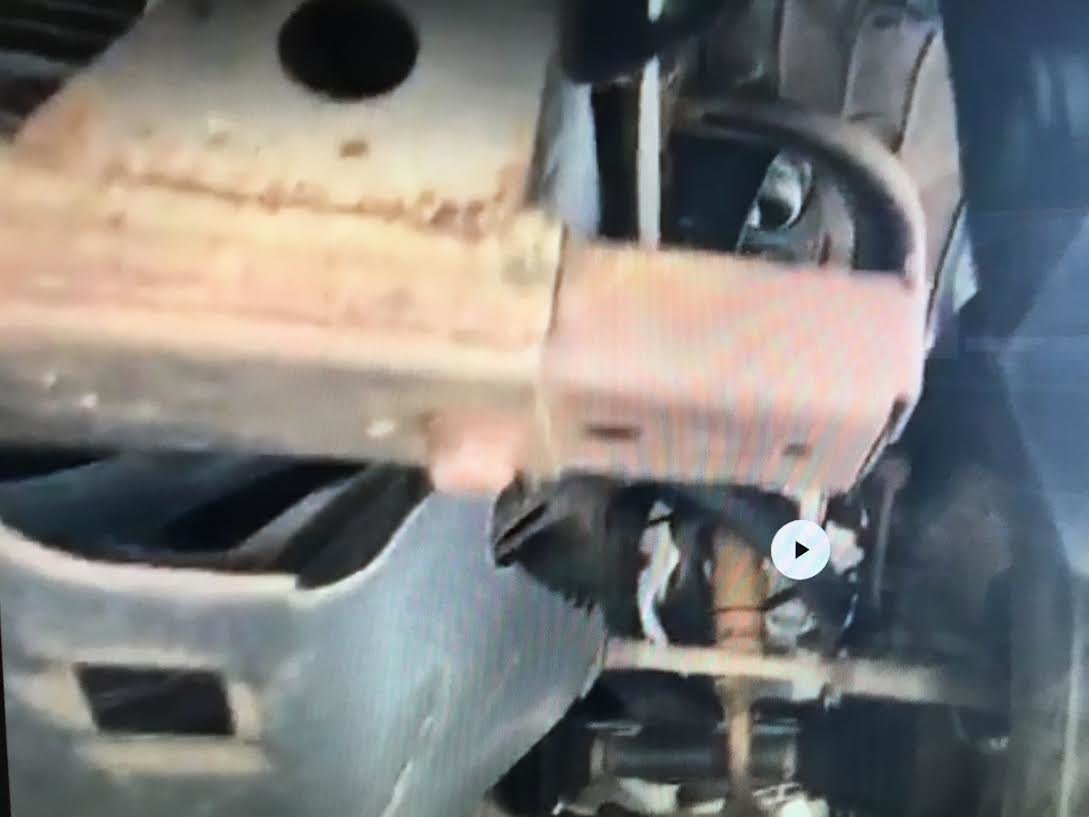

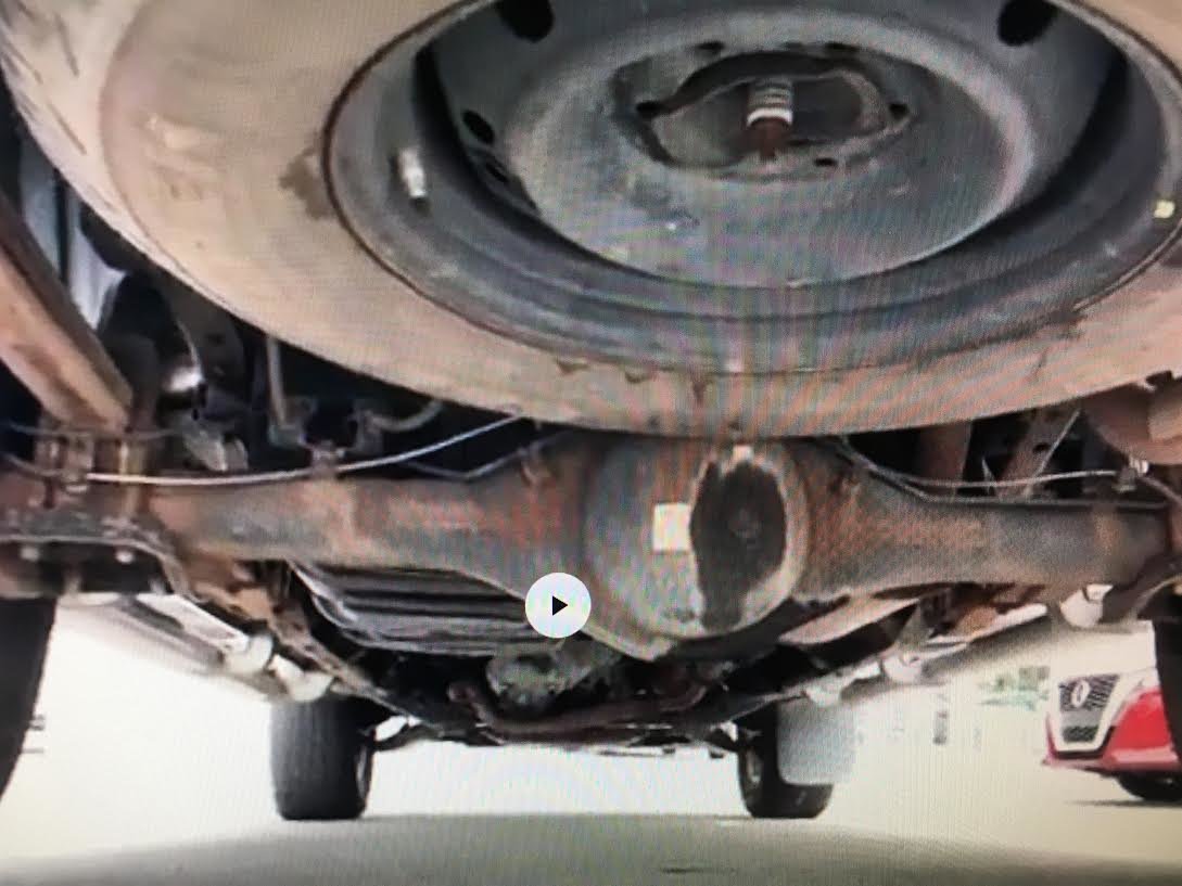

    Been a while..... I'm finally tired of my third gen runner and am trying to get back into a second gen. This time a manual after I sell the runner. They sent me a video was hoping to see if you yall had any opinions on it. It's an 07 with 136k said they would do 16k out the door for me. Here's the video. Seems there is either dirt or some rust. Carfax said 3 owners, came from Nebraska. It's now up in Rock Hill. Anyway here's the video.

    Avoid at all cost from Nebraska. Lived there for a very short period of time 8 months. Vehicles even as new as 2-3 years old full of rusted doors, rocker panels and fenders. Do not even need to watch video. Not only rust issues there roads are really bad so expect all sorts of issues.

    Well the guy in the video said something along the lines of "I feel like half of this is dirt".... Wrong, that sure looks like rust... However, the 2007 may be eligible for a new frame...
    If you can pick it up for 16 with a fresh frame... it may just be worth considering.
    the rust on the rear axle is a real turn off in my eyes...
    my initial suggestion would be keep on looking, there are some really nice used tacos out there for sale these days

    Personally I’d never buy anything from any state where it snows and the roads are salted.

    Go back after it gets cleaned up to better evaluate it's condition. I actually expected the frame rust to be worse than shown for a 12yo Nebraskan tacoma. It does have a TPMS light on but likely caused by the spare's tire pressure. IMO, I think it should be in the $13-14K range.

    hell no.... way to much rust for me.

    That is rust but at the sametime it does look like dirst as well, oh, and those tires are shit.
    Wonder if they just serviced the diff?

    For 16k, If you are truly interested, get them to put some new tires on it, change the fluids, give it a good undercarriage wash and overall detail and see what is what.
    Looks like more dirt than rust to me?
    Good luck with it man.
