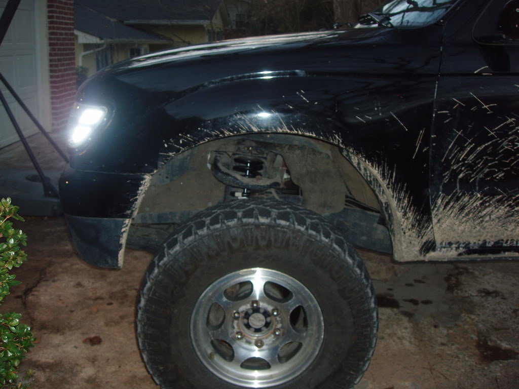

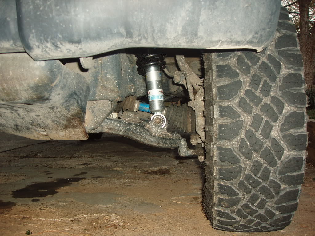

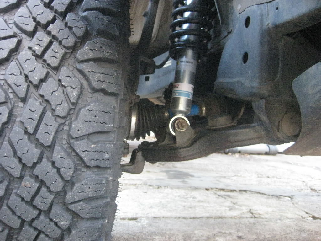

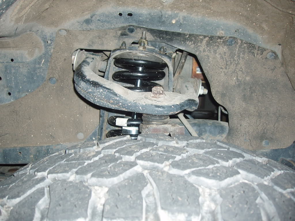

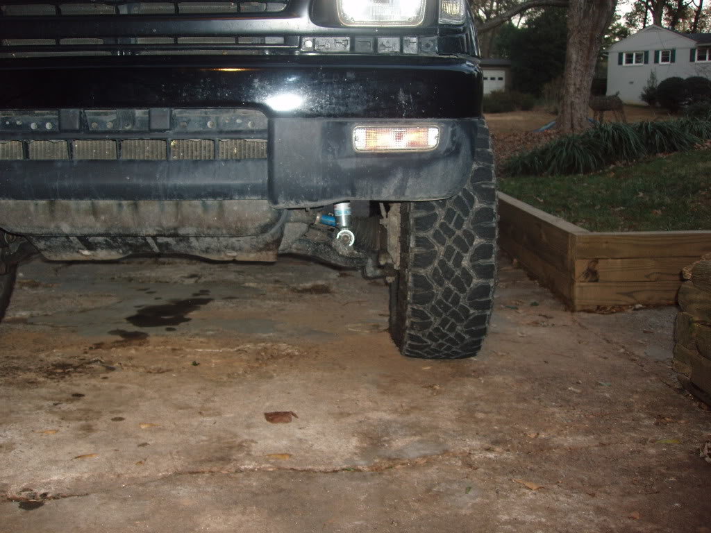

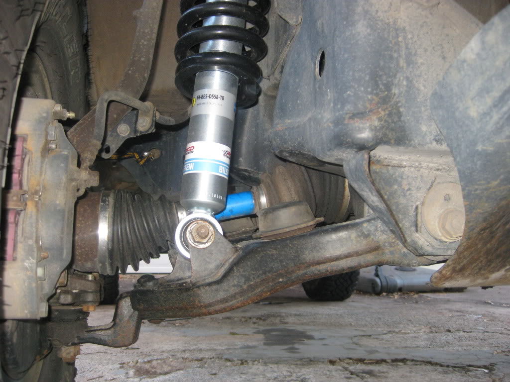

    Here are some pics:
    you guys have to remeber yes i got 4 inches of lift but thats with blowout worn to shit sagging stock stocks and coils from 1997.

    again they are 881's with billys at the middle setting...

    Looks like a little to high. The fins on your CV boots should not be touching.

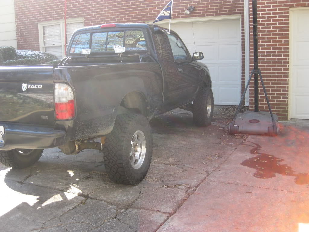

    How much of that 4" gain is from the bigger tires?

    the tires on there where on there before and after the lift was installed.

    your doing it wrong. go back and take a picture of the INNER cv boot. 4'' of lift and good cv angles is impossible...

    thats how my cv axles are ok the angle between the inner and outer fins is all the same angle so the fins on the cv bot look just the same.

    just take the picture....

    As i originally said the angles arnt bad.

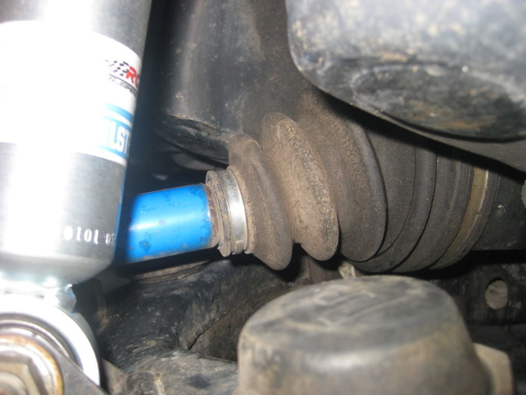

    Looks to me like those boots are touching.....Prepare to replace them when they begin to tear.

    they are close but they arnt touching yet. i thought it was ok if they touched a little bit? like one fin?

    I see a black ring around one of the fins. Thats an indicator they are touching.

    Still scratching my head as to how you confused .5" with 4".........Anyway, the angle is a bit much. As Chris said, they will eventually tear as more miles rack up. I bought my truck with 3" lift, he said the lift had been on for 10k miles. I drove it for 1k more miles and the passenger boot tore. I then looked at my drivers side boot and the fins were touching (yes only 1), and it was very close to being gone. Better read up on how to replace boots soon or drop the billys to 0.

    don't they rub slightly from suspension articulation and or turning?
    but I agree, they will eventually wear out.

    At full extension, Yes, But how often do you drive with your suspension fully extended?
