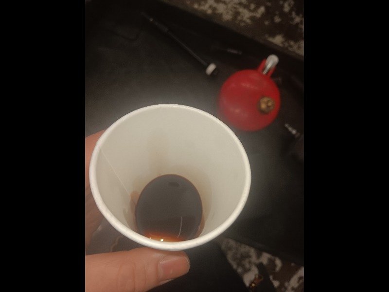

    Update, mechanic trying to tell me that metal flakes in fluid means the trans is shot and they changing fluid might cause it to seize??? I was under the understanding that metal shaving was expected with normal wear and don’t see how that would cause it to seize.

    The trans fluid

    If you took the truck to a couple different reputable transmission shops and they both gave you the same information that the trans needs internal work , I would go with what they are saying . Those guys do this stuff every day
    If you drop the transmission pan and find metal flakes inside , its usually a sign that something in your transmission is coming apart .
    I would never tell a customer the transmission is shot . Shot means beyond repair
    I will tell a customer that the transmission has to come out and all apart to see what component is starting to fail .
    There are 1,700 moving parts in the average overdrive transmission . Its a tough call trying to isolate and identify what component is failing from the outside of the transmission .
    Seldom have I seen an automatic transmission seize . They have to get very hot for that to happen
    I have seen automatic transmissions leave many people stranded mind you .
    Did the shop take the pan off ?

    I'm curious about the fluid though. Mine looked foul enough at it's 60k drain and splash, but no noticable flakes. Mine was also not as dark as OPs photo, though it's hard to tell over a screen, without a flashlight or a paper towel sample. If there's glitter, I always thought that was cause to investigate the trans further.
