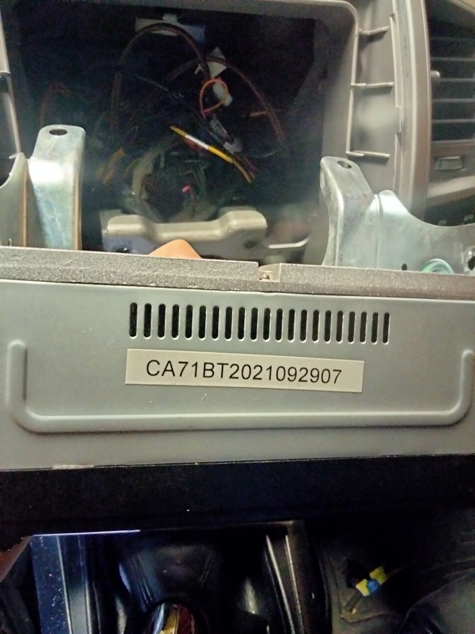

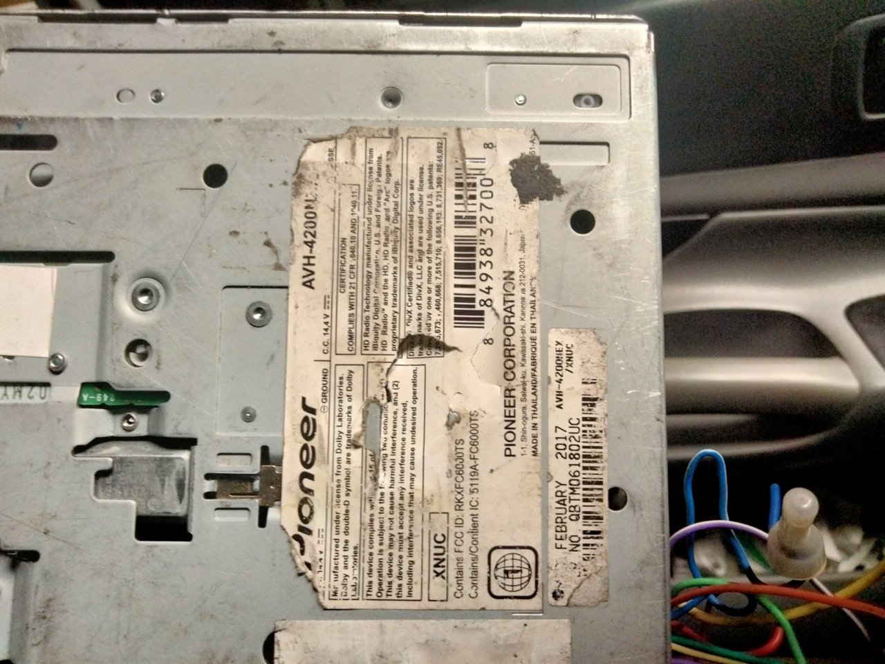

    can you list the model numbers of the parts that the person was supposed to install? i see lots of pieces, it appears to be at a minimum a radio, and an amp with a bass controller?
    you said a pioneer radio was already installed in the truck?
  2. Sep 7, 2023 at 6:30 PM
    #22
    Jalisciense27
    Jalisciense27 [OP] 2005 Tacoma Prerunner V6
    Sep 6, 2023
    #432956
    19
    Victorville, Ca
    2005 Tacoma
    Correct. The pioneer was already installed but my ex punched the screen and broke so I bought another one , just basic replacement thinking it was the cheapest way to replace the pioneer one :( Let me go grab the info of the stereos

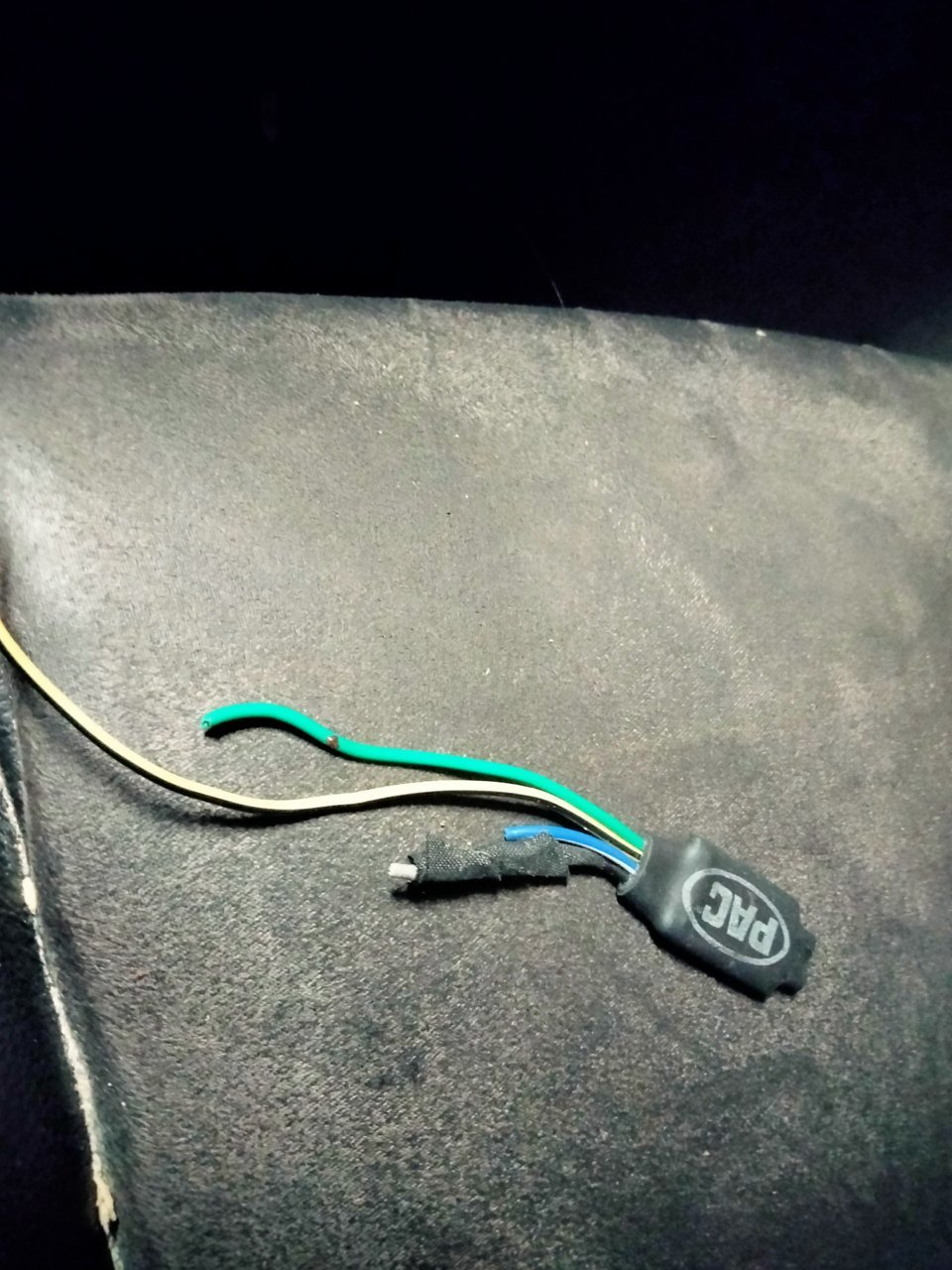

  7. Sep 7, 2023 at 6:56 PM

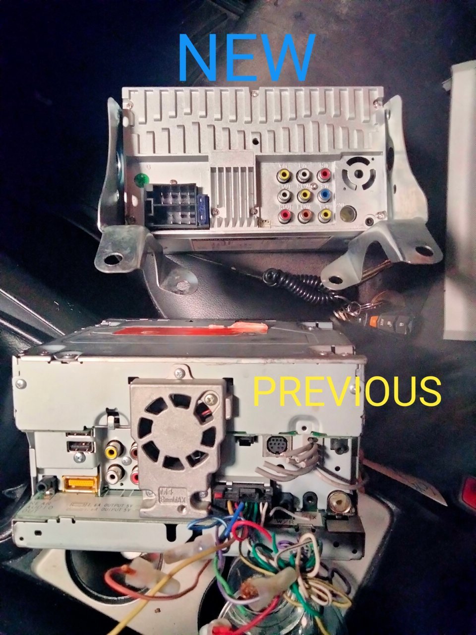

    Well, at least that narrows it down to the area of your problems. I would completely remove the stereo and put everything back the way it was, kinda difficult since you didn’t do the work. Did you check ALL your fuses? There are some under the hood too

    Sheesh what ugly wiring. Feel bad for ya. It's important to find people that are highly recommended for work. Things like this are unlikely to happen with a reputable installer/technician.

    He also forgot where this went so he didn't connect it...

    That looks like a video bypass module so that the headunit can play videos while in gear. It's not really necessary. I noticed you said you replaced the fuses because you didn't have a tool to check them? If you pull the fuse out, you can visually inspect them because they have clear plastic with a fuse link between the posts.
