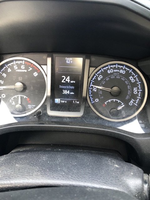

    put a bottle and a half of Heet in the tank and incidentally disconnected reconnected the battery to clean the terminals. ran great for 19 miles. Now it will not go above 27 miles an hour and I have a check light on. Also odd, a full tank usually says about 260 miles to empty now it says 385. I’m letting it idle for a while to burn some gas with the heat on full blast.
