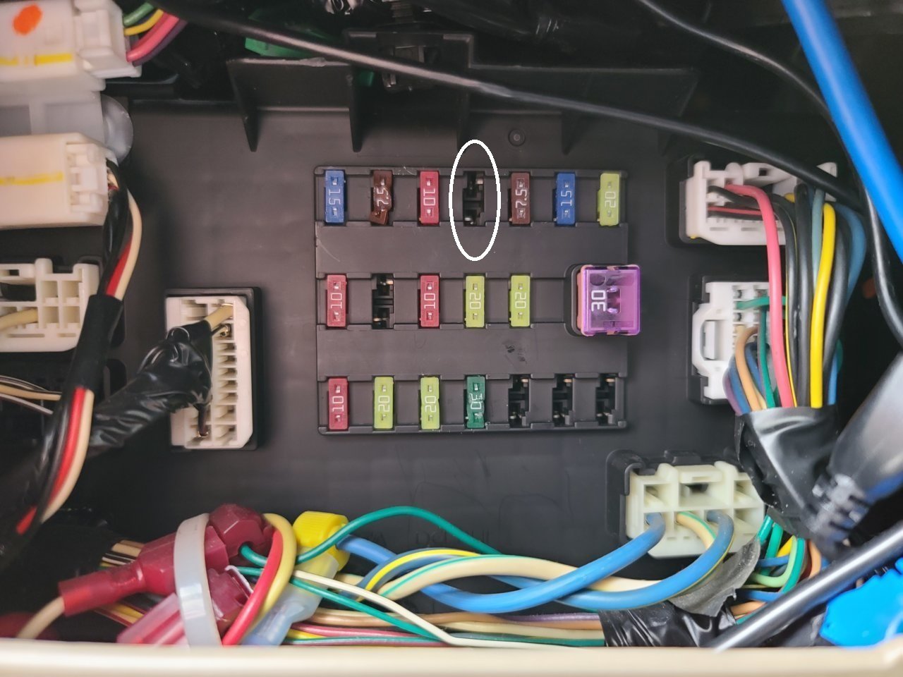

    Hey,
    Can someone recommend a good spot on the fuse box under the steering wheel? Trying to avoid going through the fire wall.
    Looking for ACC and a + with two ADD A FUSEs spots.
    Thanks

    This is where I used an add-a-fuse for my temp/compass mirror.
    and, what's up with that 7.5A fuse?

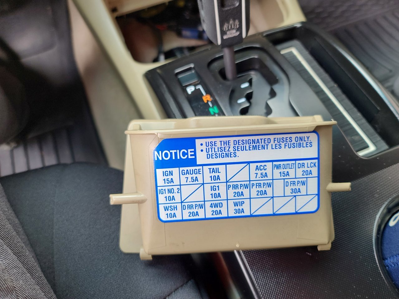

    Did you run the acc or the + in that slot?
    7.5 Acc fuse or the 7.5 guage fuse?

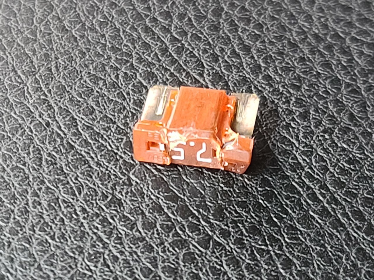

    Oh lol I just noticed it. I'll pull it out and look :D

    The add-a-fuse I used gets it's power from the 7.5 amp fuse to the right of the empty space. It has power when the key is in ACC or IGN.

    Lol No idea how that happened. It's never been pulled. :anonymous:

    Did someone use a fuse puller, pliers or their teeth? :eek:
