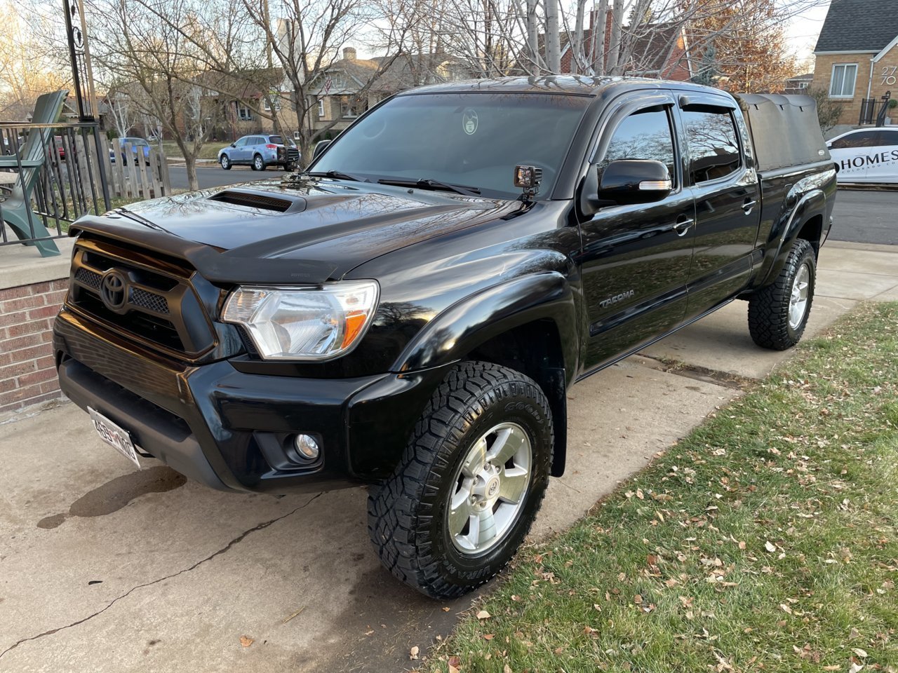

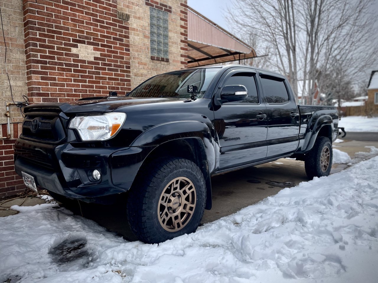

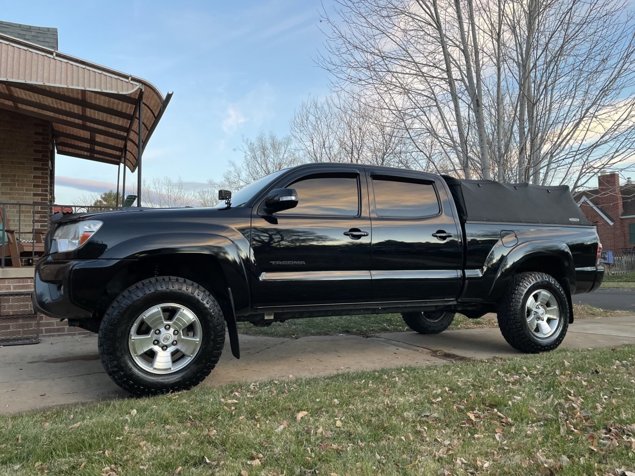

    Don't you just love these old brick houses in Denver? Great looking street you've got there, much like mine!
