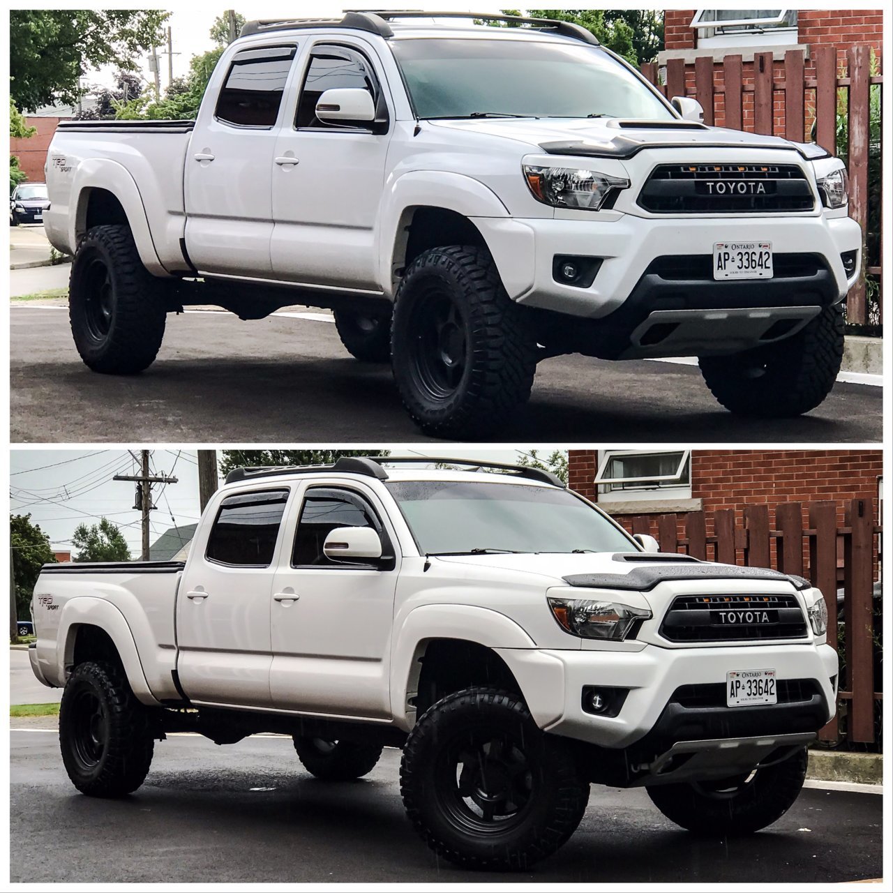

    I did my body lift in two days, could be done in a day easily. Take your time and only lift the body just enough to squeeze in the spacer, learned that the hard way and ripped an ABS wire. :)
    Before/After
