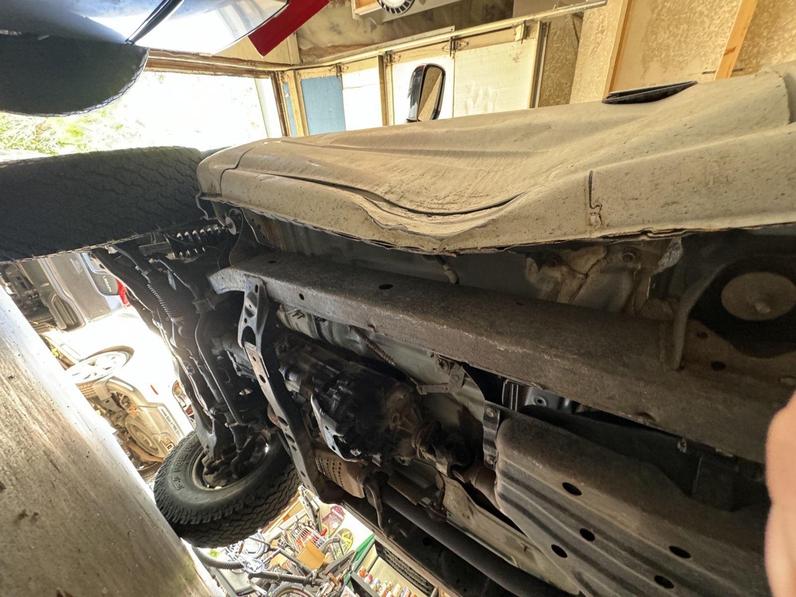

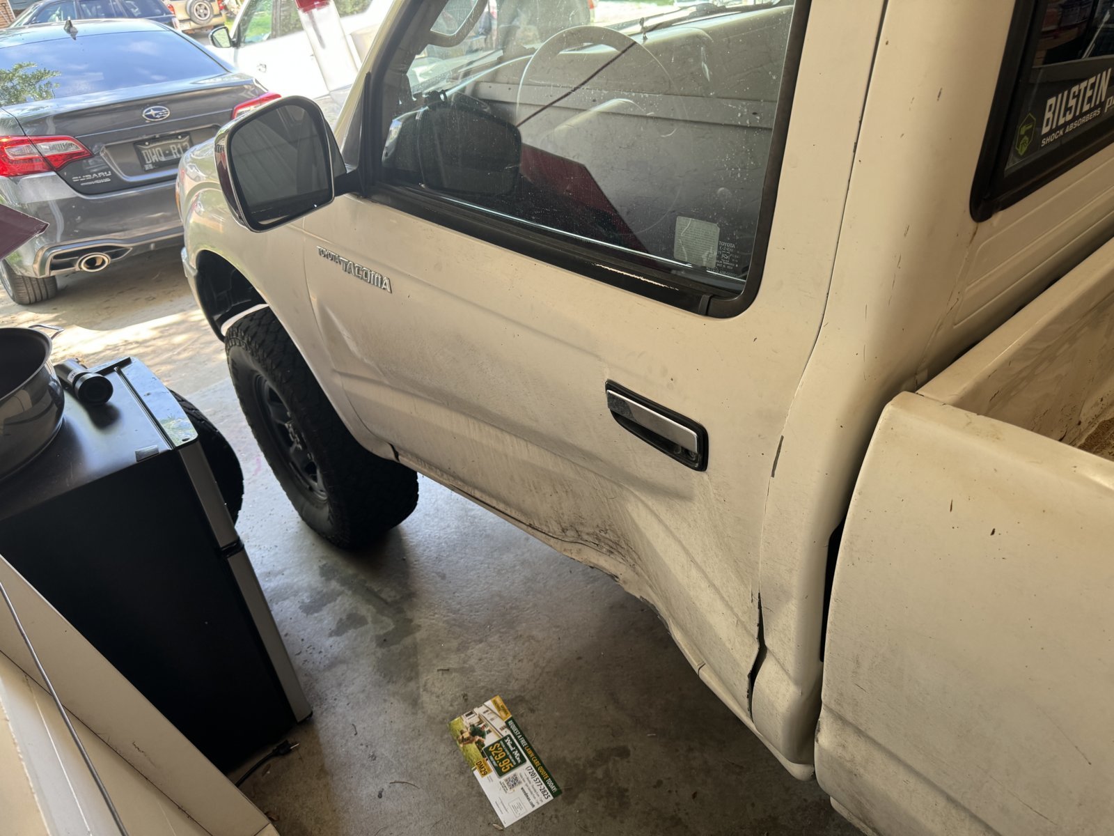

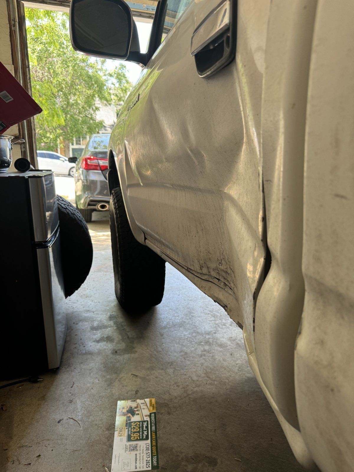

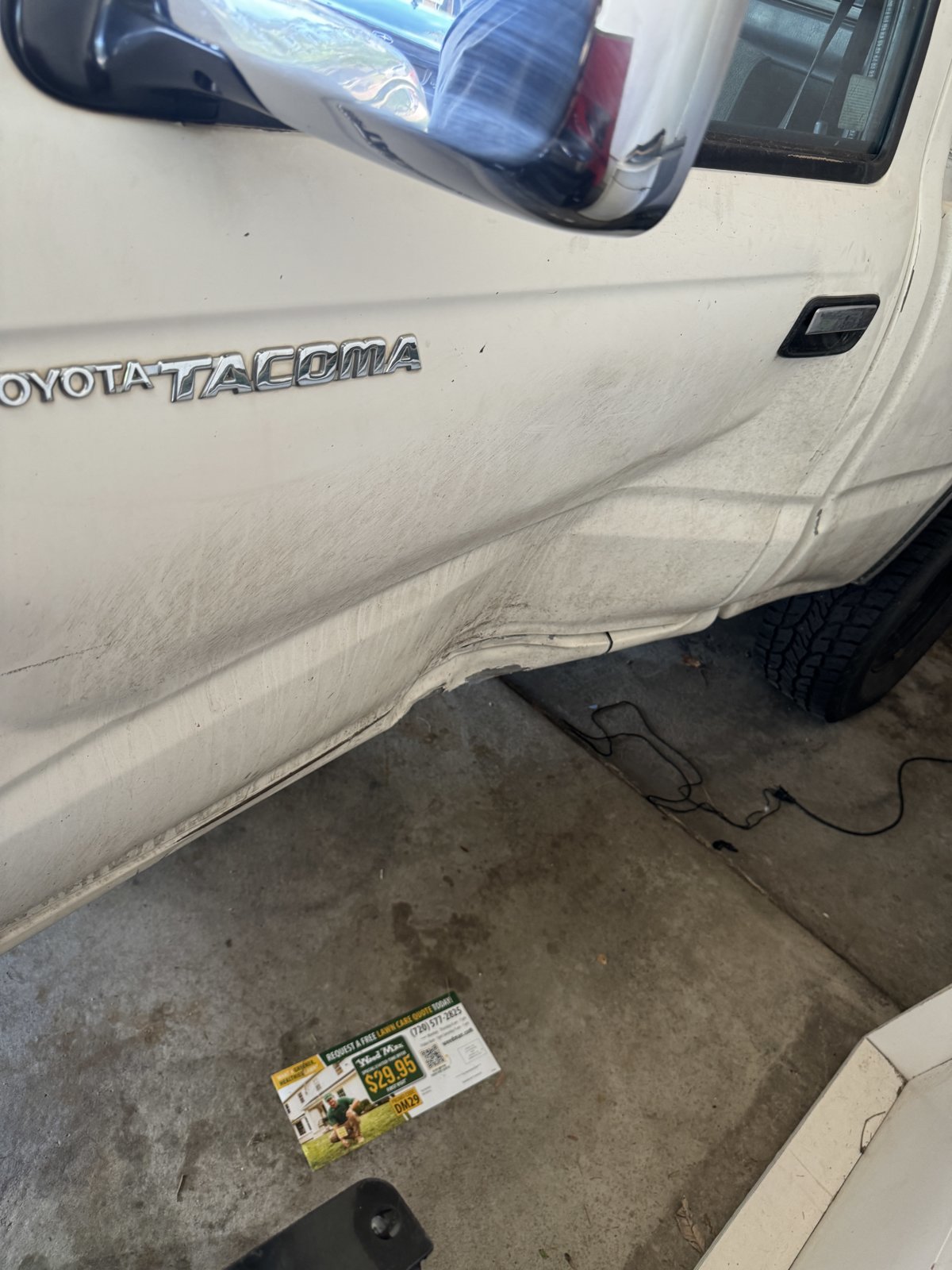

    Got T-boned back in February. Insurance isn’t covering it, anyone know a good body shop, not looking for cheap work but reasonably priced would be nice. Looking for quotes mainly.

    the cost to rebuild all that will be... immense. seems the frame looks straight.. i would second finding a new cab (but you will need the title to the cab you buy to be legal. the vin follows the cabs on passenger vehicles )

    To fix that you will need a new inner and out rocker and probably a floor. I would talk to some shops about a cab replacement in Colorado repair shops can replace the cab without changing the vin on the truck. But for it's age repairing it would be costly.

    I can’t imagine any decent shop or person who knows what they are doing would undergo trying to repair that opposed to a cab swap. Cab mounts have to be tweaked, needs a whole floor pan, rocker and I suspect cab side (which is not a thing). Keep in mind the integrity you enjoyed from the last collision. Doubtful that “repaired” cab would hold up as well if it were to happen again.

    some shops will just pull the stuff straight and make it "look" pretty. structurally. that thing needs ALOT of parts replaced. you can straighten all the metal you want. but the damage is done to the cabin. unless the photos make it look worse than it is, damage like that would of totaled the truck when it was only a couple years old

    replacement cab would be wayyy cheaper than the amount of work needed to straighten that.
