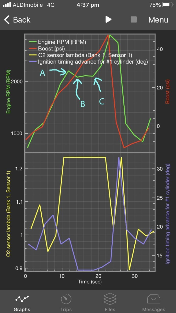

    Hi All, thanks in advance for any input. I have acquired a supercharged 1GR-FE truck but its got a bad stutter around 2000 rpm but runs totally fine at high rpm. These are the poor truck's symptoms
    •Hesitancy between 1900 – 2400 rpm (consistent)
    •Worse under load (up a hill). Maybe that just makes its lack of go more noticeable
    •OBD scanner shows lambda running very lean in that rev range (lambda 1.25)
    •Car is taking out advance to protect itself
    •AF commanded drops 14.7 to 13.7 but actual goes 14.7 to 18 when it stutters

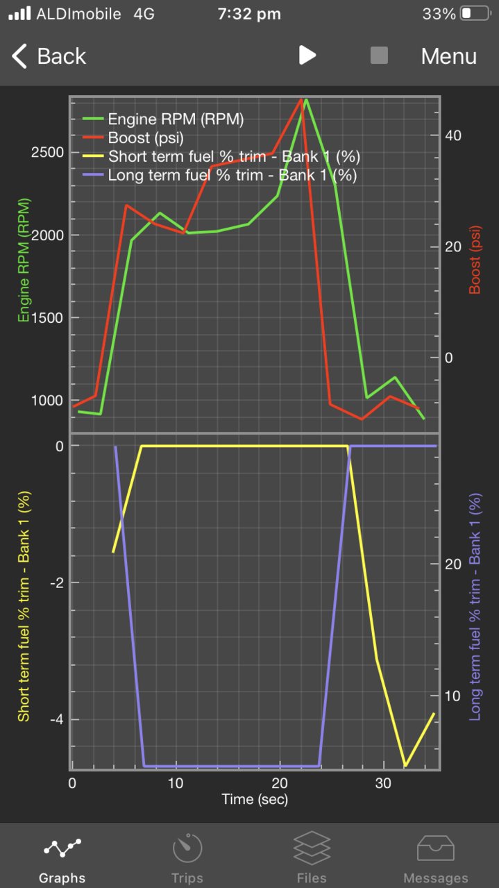

    •Short term fuel trim doesn't vary too much but long term fuel trim is not normal (see image)

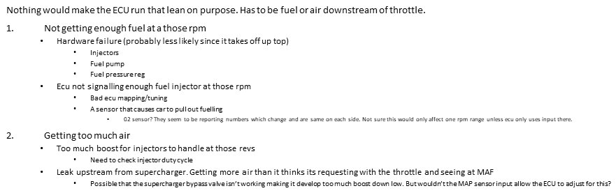

    Nothing would make the ECU run that lean on purpose. So my thinking is it can only be too little fuel or too much air
    1.Not getting enough fuel at a those rpm
    •Hardware failure (probably less likely since it takes off up top)
    •Injectors
    •Fuel pump
    •Fuel pressure reg
    •Ecu not signalling enough fuel injector at those rpm
    •Bad ecu mapping/tuning
    •A sensor that causes car to pull out fuelling. 02 sensor? They seem to be reporting numbers which change and are same on each side. Not sure this would only affect one rpm range unless ecu only uses input there.
    2.Getting too much air
    •Too much boost pressure (or more than ECU expects) for injectors to handle at those revs. Need to check injector duty cycle
    •Leak upstream from supercharger. Getting more air than it thinks its requesting with the throttle and seeing at MAF
    •Possible that the supercharger bypass valve isn’t working making it develop too much boost down low.
    I've attached an OBD scanner output as I go up a hill and the truck bogs down. Point A is where it changes down a gear as the hill starts. Between B&C is where it struggles. The bottom half of the first graph shows how lean it gets and the car pulling advance out to protect itself. The second graph shows the fuel trim which overall is trying to richen up the mixture by a big amount to compensate.
    The issue is changing injectors needs the supercharger off and the injectors are expensive. I've swapped the MAF but no difference. Sprayed brake cleaner around but it didn't produce an increase in rpm so probably no leak. I guess I could put a fuel pressure meter on the rail but it runs fine at big rpm flat out. I can't see where my Techstream lets me check the fuel rail pressure.
    The two narrow band sensors after the car converter are happy enough at idle flicking between rich and lean nicely. What can make it bog down at lower rpm like this? What is the next thing to check or swap, wide band o2 sensors from a wreckers?

    Boost is a calculated value in the scanner app so best not to take the nearly 50psi as an actual number, its more about the direction of the levels.

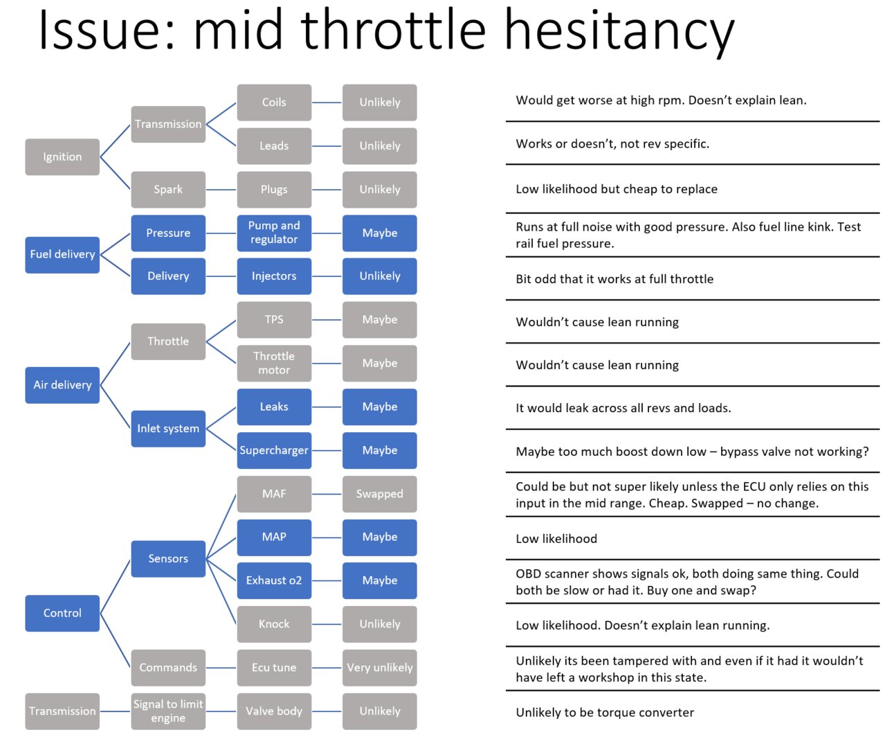

    @12TRDTacoma (&Lucario) I've swapped out the MAF and no change. I will do the fuel pressure rail check first. I had assumed that because its fine at big rpm it couldn't be this, but sounds like the wrong assumption. Hopefully there is a simple port to plug a gauge in to. Fuel pump not an expensive swap in any case.
    @Fullboogie I sprayed brake cleaner around but didn't see much change. When I sprayed some into the throttle it took quite a bit to get it to change rpm so maybe a small leak wouldn't have been detectable. Because its running lean I took a look at all places between the MAF and supercharger because if it was going to get more air into the cylinder without the MAF measuring it I thought the leak would be there. If the leak was between supercharger and cylinder it would be getting less air not more. But it sounds like you are saying to check a bunch of other hoses as well?
    @Dm93 I did consider the o2 sensors, they do seem to be both the same reading at idle between the narrowband sensors downstream of the cat and the widebands between engine and cat. It is possible that the widebands are reading wrong at other AFRs. Both banks read the same so no obvious issue with just one of them.
    Might seem a bit much but I created a flowchart to get my thoughts straight. Only other thing I could see was the boost does seem to rise very quickly which could lead to a lean issue but I don't know much about how an ECU controls supercharger boost.
