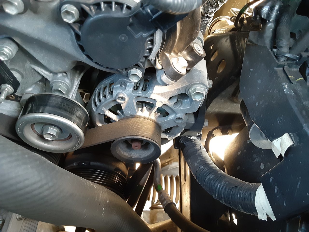

    But does anybody have cable lengths for the stock cables?
    I want to do a Big 3 upgrade on all my stock cables, but the company I am ordering from is asking me for the length to cut send me new ones.
    I am looking for the lengths for OEM battery wiring and measured from end to end OF THE TERMINALS, not the actual wire itself.
    1. Positive Cable to starter
    2. Positive Cable from battery to fuse box
    3. Positive Cable from alternator to fuse box
    4. Negative Cable to transmission housing
    5. Negative to frame
    6. Alternator body to frame
    Anyone smarter/ has done this, can you help share your knowledge for me to request/order. New cables will be all 1GA.
    Here a picture from someone else @C7mb
    who has done it on his Gen 2, look how neat they are?.
    Gen 3 Tacoma stock alternator sits on the driver side of the Engine Bay,
    mounted to the engine below the battery, see below from mine.

    I know, but it's no easy task especially given how little space is there. I went under there, removed the skid plate, removed that first plastic housing , there's one more and also a hose through which the cables go to the alternator to protect from heat.
    It's not gong to be easy at all, and takes easily half day just to get all the wires out to measure and put back.

    Like I said, it's not an easy task., I tried, I removed the shrouds, plastic tabs, removed the skid plate, and there's still a hose through which many of the cables are run through, Also, very little space to put my arm in. That is why I am asking if someone else has done it before me.
