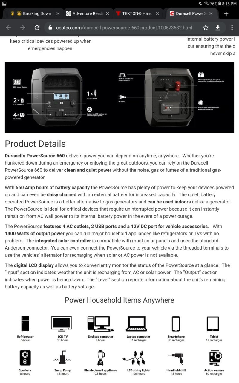

    Can you send me any info saying only last 30 hours

    Per the specifications, this is a 55 amp hour, flooded, lead acid battery.
    Lead acid batteries only like to be discharged to roughly 50% capacity before they start to be damaged, and their life span starts to deteriorate significantly.
    This means you have about 27 amp hours available to power the fridge. (55 x 50% = 27.5)
    That fridge will draw roughly 0.8 to 1.0 amps per hour.
    27.5 / 0.8 = 34 hours of use (that's assuming the fridge is pretty efficient and only drawing 0.8amps/hr)
    I have a similar refrigerator, and it's power usage is ~1amp/hour.
    You can see on the Costco website, that they say it can power a desktop computer for only about 3 hours.
    I just don't want you to think this can power your refrigerator for a long weekend without recharging, and the battery last for more than a year or so before you need to replace it.
    Cheers

    You probably know this, but please note that what I stated above regarding how long that battery pack might last is based on using the 12v port. If you use one of the AC ports, expect the length of usage to drop off quite a bit.
