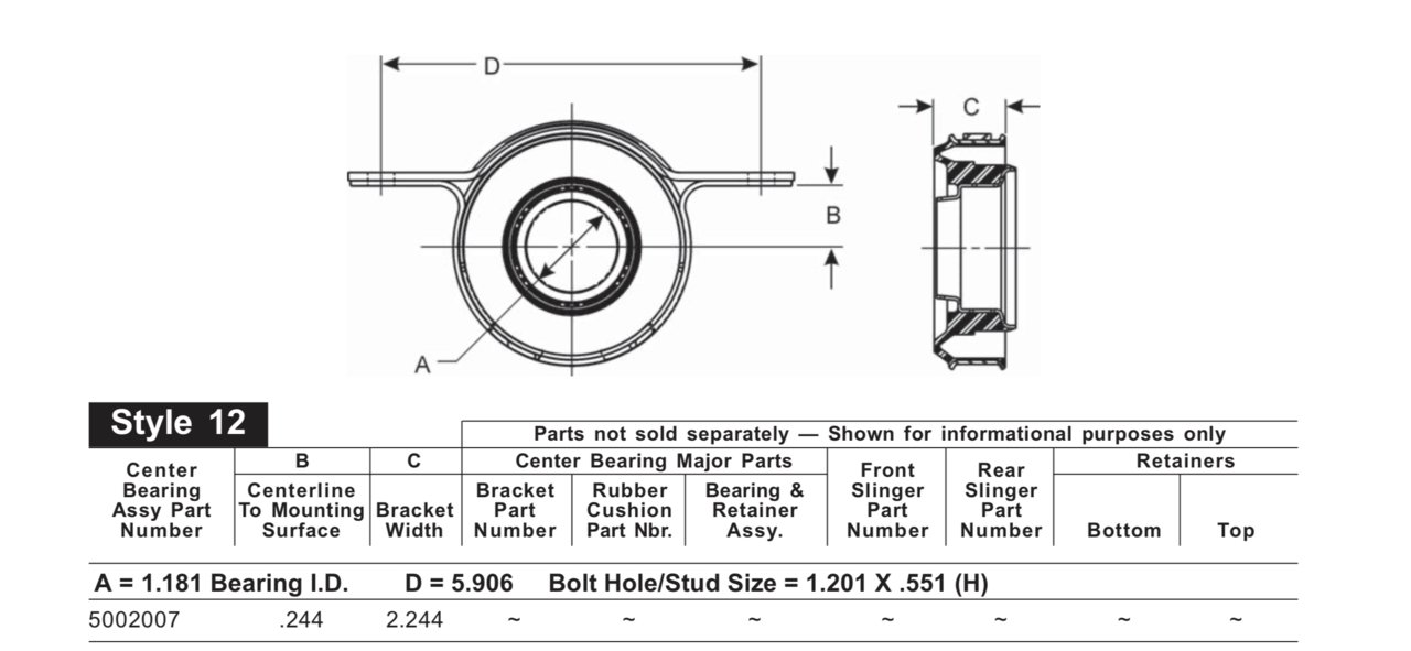

    Does anyone have an OEM or Spicer 5002007 carrier bearing lying around? I'm curious what the inside bearing width is.

    ID of the bearing is 1.181in

    Here’s all the bearing dimensions, but the actual bearing width is not given. Width would be front to back, as it’s positioned in the truck.

    I saw that, bummer it doesn't give the actual bearing inner race width. I might be forced to pick one up just to measure
