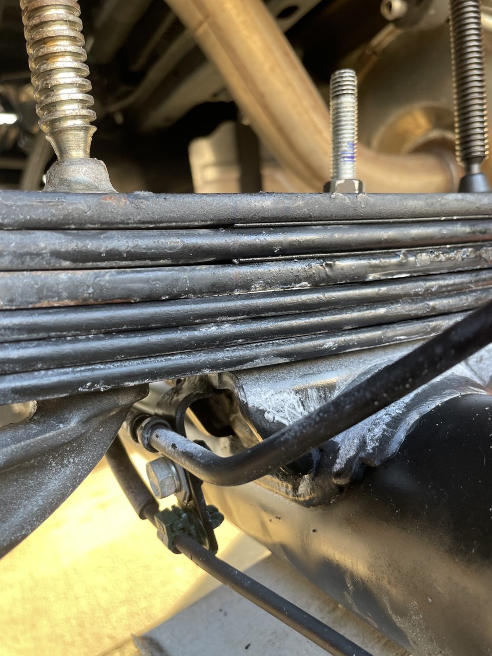

    I’m in the middle of it right now and didn’t realize I didn’t have the spec for the center pin bolt/nut. I clamped it down as much as possible, still have slight tiny gap between 1 or 2 leafs.
    anyone help me out before it gets completely dark?

    Shit come to think of it the tiny gap is between the 3leaf aal and the stock pack.

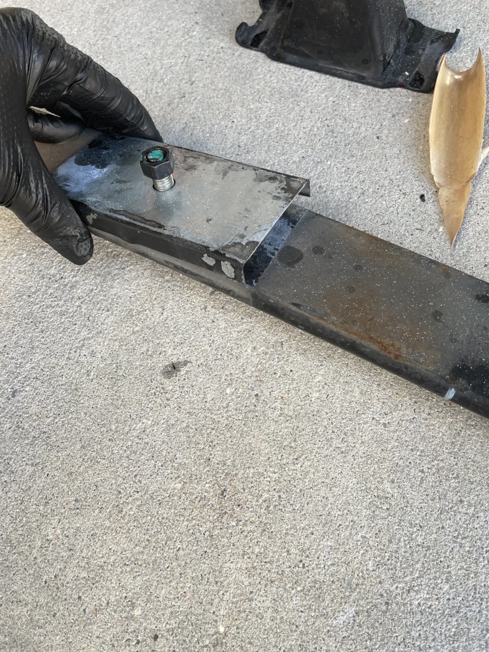

    was this plate from the top of the overload supposed to go on top of the aal? That’s where the gap is

    yeah that little thin plate goes under the leaf pack on the perch. Don’t really think it’s necessary though.

    But it wasn’t on the bottom of the overload contacting the perch it was on the top between the 2 leafs

    I took out the overload when I put the 3leaf aal in and no mention of putting it on top of the aal pack

    don’t worry about it then imo.

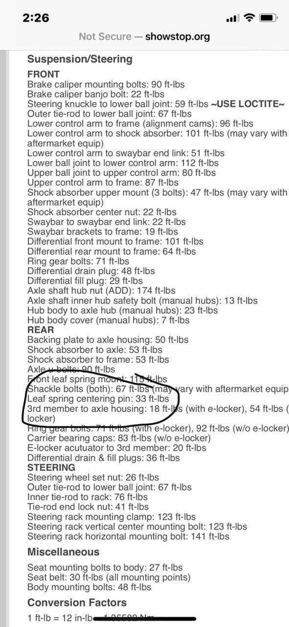

    Alright job is done and I’m settling down relaxing. Just wanted to say I appreciated the reply and didn’t want it to seem like just a wham bam thank ya ma’am thing earlier.
    out of curiosity what did the spec sheet come from (specific vehicle)? Was just looking over some of the other specs and they definitely differ from mine.
