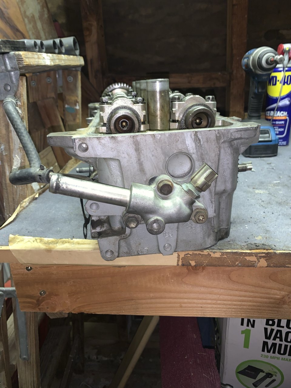

  8. Mar 14, 2021 at 4:17 PM
    Allex95
    Allex95 Well-Known Member
    Apr 6, 2020
    #324011
    1,380
    allex
    96 Tacoma 4x4 2.7l 4 cylinder
    this sensor

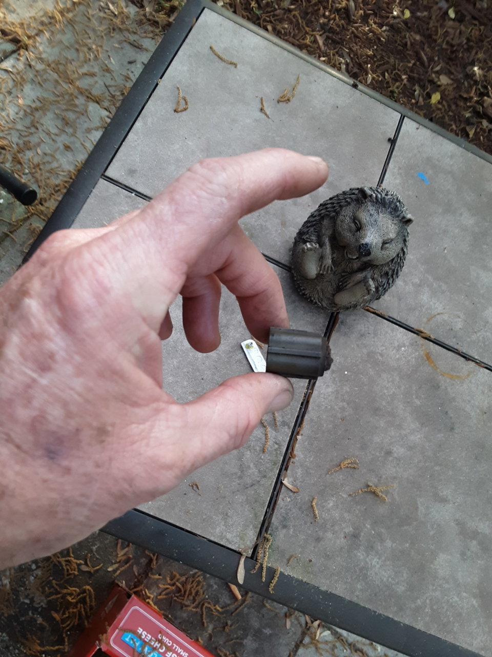

  17. Mar 15, 2021 at 3:39 PM
    #17
    F.I.LetsGoFishing
    F.I.LetsGoFishing [OP] Well-Known Member
    Nov 9, 2011
    #66729
    162
    95.5 4wd 3rz mt
    Neglected Original
    guess replacement either way. went to pull the lead and came up with this still in the connector.20210315_182629[1].jpg
  18. Mar 15, 2021 at 3:44 PM
    #18
    Glamisman
    Glamisman Well-Known Member
    Oct 22, 2016
    #200436
    4,940
    You found a hedgehog in your motor? he he he...
  19. Mar 16, 2021 at 3:38 AM
    #19
    Wyoming09
    Wyoming09 Well-Known Member
    Apr 24, 2015
    #153833
    14,277
    New Tripoli Pa
    2000 Work truck 5 speed 4x4 3.4
    Super Springs
    It seems that may be the cause of your code .
    Open circuit or resistance so high the ECM just said this is broke!
