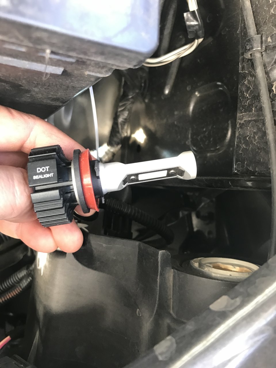

    Halogen=DOT Legit , LED=NADA

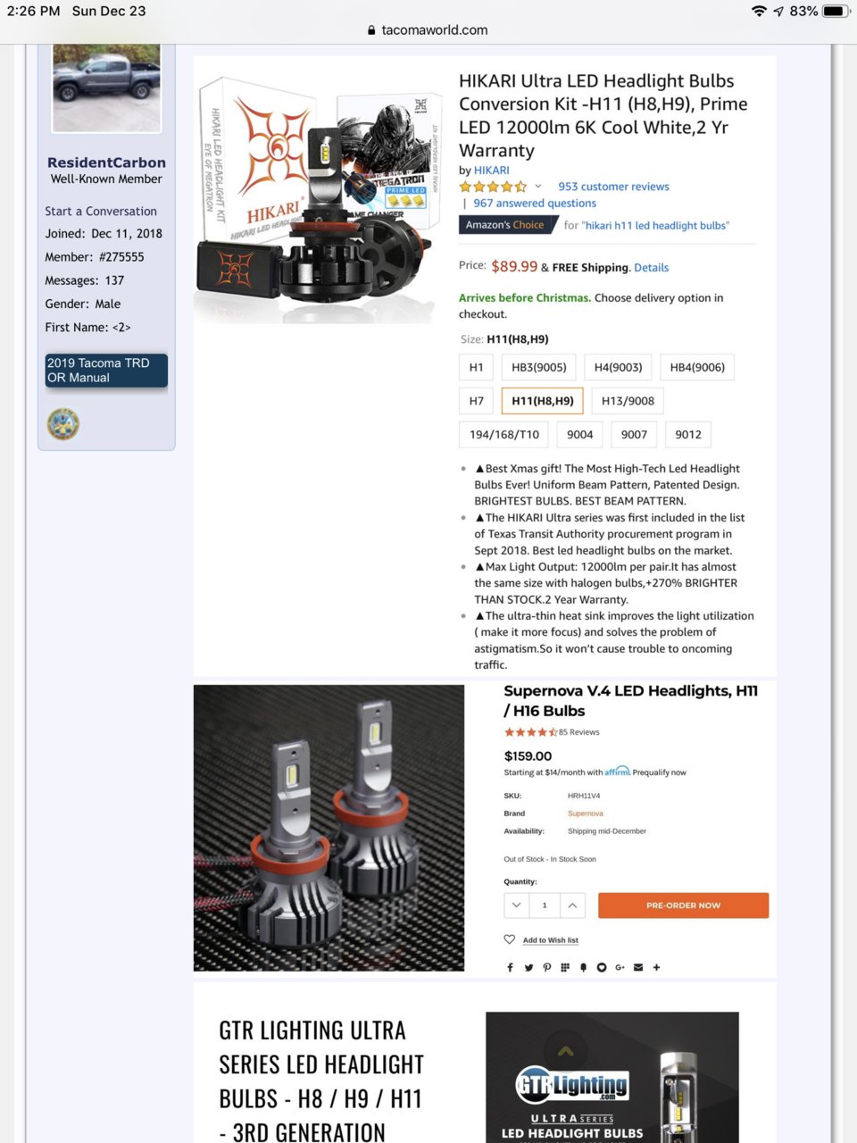

    Look here

    I wanted a plug and play LED replacement so I would not have to modify the truck. I tried various replacement halogen blubs but I either did not like the color of the light or the intensity was less than the original bulb. Tried several LEDs and liked the color of the light but the intensity was less than the original halogen and the light scattered to much out of the trucks original lens.
    Finally I tried the HIKARI LEDs and they fit the car without any modifications. The color looked great and they were the brighest LED or halogen I tried. Another advanage of the HIKARI is that they are ajustable for desired beam patterns. Great LEDs and I recommend them for ease of installation and great lumination.

    Yeah. Anyone can print anything on their product they want. Remember when there was such an anti Japanese sentiment in the U.S. market that many Japanese products were made in a part of Japan called Usa. They were marked: Made in USA, which was technically correct but rather misleading.
