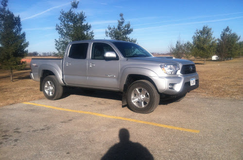

    I want to get these wheels:
    For this truck(2012 Tacoma DCSB TRD SPORT):
    Where I need Help is; Can I do the 9inch Wide Rim? the 9s offset is -24 the 8s offset is 0. the stocks are 7.5 inch wide alloy:confused:
    Bolt Pattern: 6x139.7 Rim Width: 9 or 8
    Hub Bore: 108 Rim Diameter: 17
    Rim Brand: American Racing ATX Slot Black Offset: -24(9s) 0(8s)
    Manufacturer Part Number: AX18679060724N-set Number of Bolts: 6
    Rim Structure: One Piece
    Second part of question: I believe I can use the TPMS from the stocks on these wheels, am I wrong?:confused:
    thanks in advance!

    What size tire do you want to run?

    I will have the answer once he notes the tire size, which is the single most important factor in this :laugh:
    The 8's with the zero offset are going to be a better choice unless you are trying to fit some huge tires. The backspacing on the 9s is slightly too low, and the 9s are going to be too wide to run with some 265s.

    Planning on running the stock 265s for now, lift and tires later when budget allows.

    in this case go with the 8 wide wheels.
