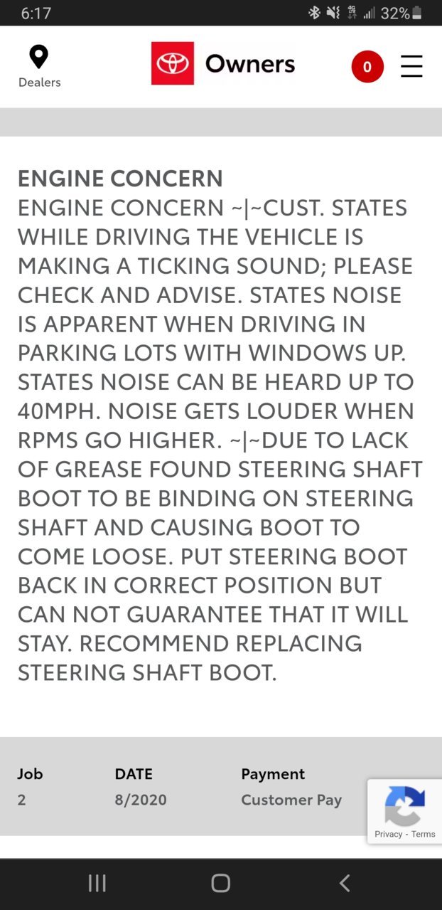

    @Jack emerson attached is a screenshot from Toyota owners of what they did to fix this. Ended up just having them replace it . Its been good so far Screenshot_20220826-061721_Chrome.jpg

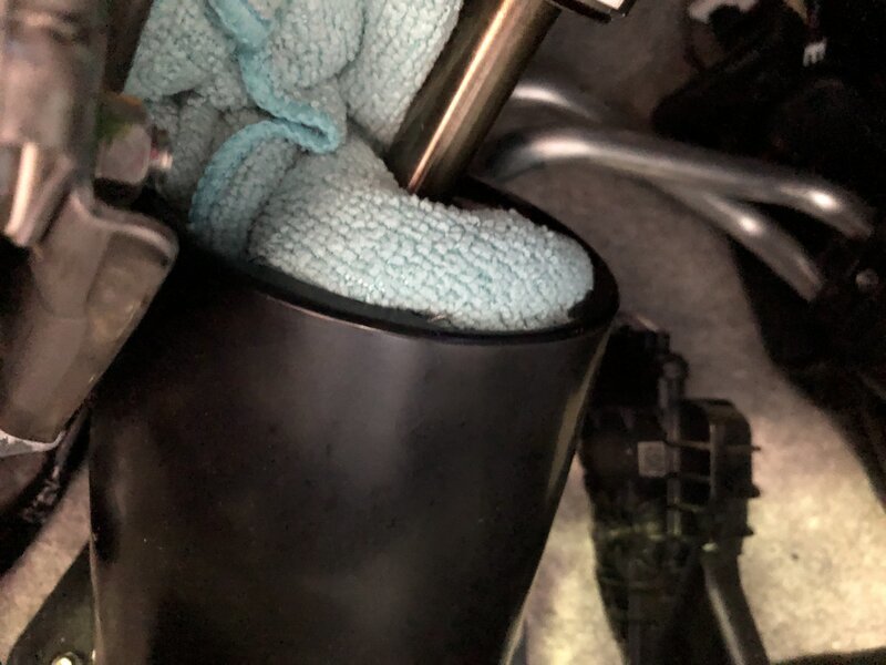

    Bulalo, You are hitting it out of the ball park! I took your first recommendation that it was noise coming in from the steering shaft. So I stuck a small towel in the plastic covering/housing leading into the floorboard/firewall.
    Sure enough the clack-clack sound in the cab disappeared. Truck sounded great. Noise gone.
    But my solution was a temporary solution only to locate the problem. Your post that I quoted about gives me the information how to properly fix this noise issue.
    Thank you so much for taking the time to help me. I would have never have considered the steering column being the problem.
    Here’s a pic of me stuffing a towel into the steering housing that goes to the floorboard/firewall that deadened the sound. In fact, the truck is quieter than before.

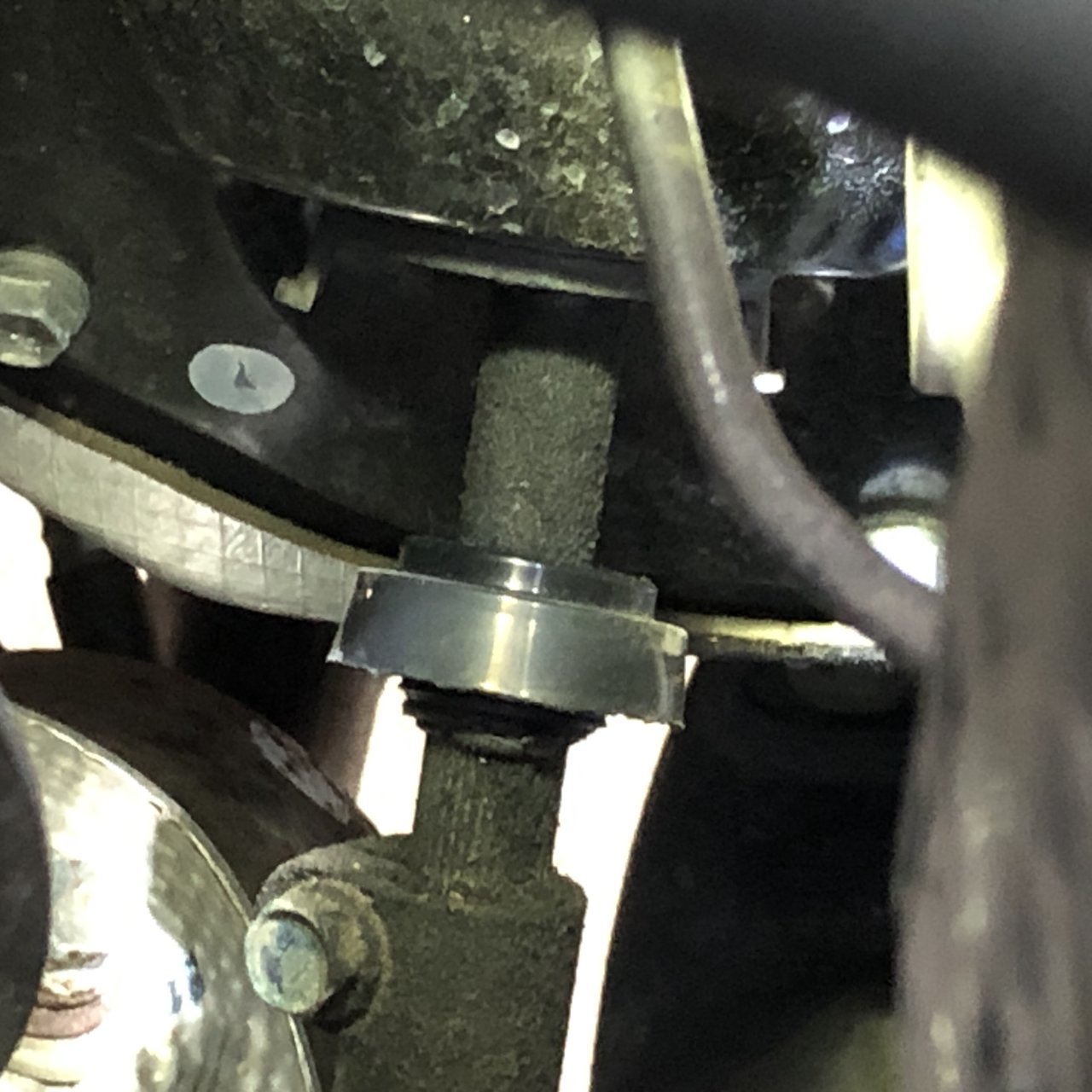

    I took the truck to the dealership for the second time. Since you helped be locate the area of the noise being the steering column near the firewall I was able to get their attention much better.
    Service tech checked it and found that the “shaft bushing is torn and cracked.”
    It’s a round thing that has now slid down the intermediate shaft.
    They are going to replace the “Cover Sub-Assembly.” The part has to be ordered. Part #45025-04050.
    Here is a picture of the shaft hushing cover that has separated from the main assembly.
